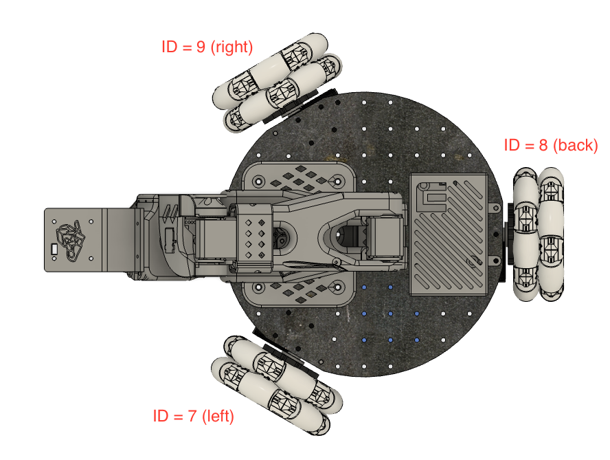

Motor ID's for mobile robot

Mobile base (LeKiwi)
Assemble LeKiwi

                    "gripper": [6, "sts3215"],
                    "left_wheel": (7, "sts3215"),
                    "back_wheel": (8, "sts3215"),
