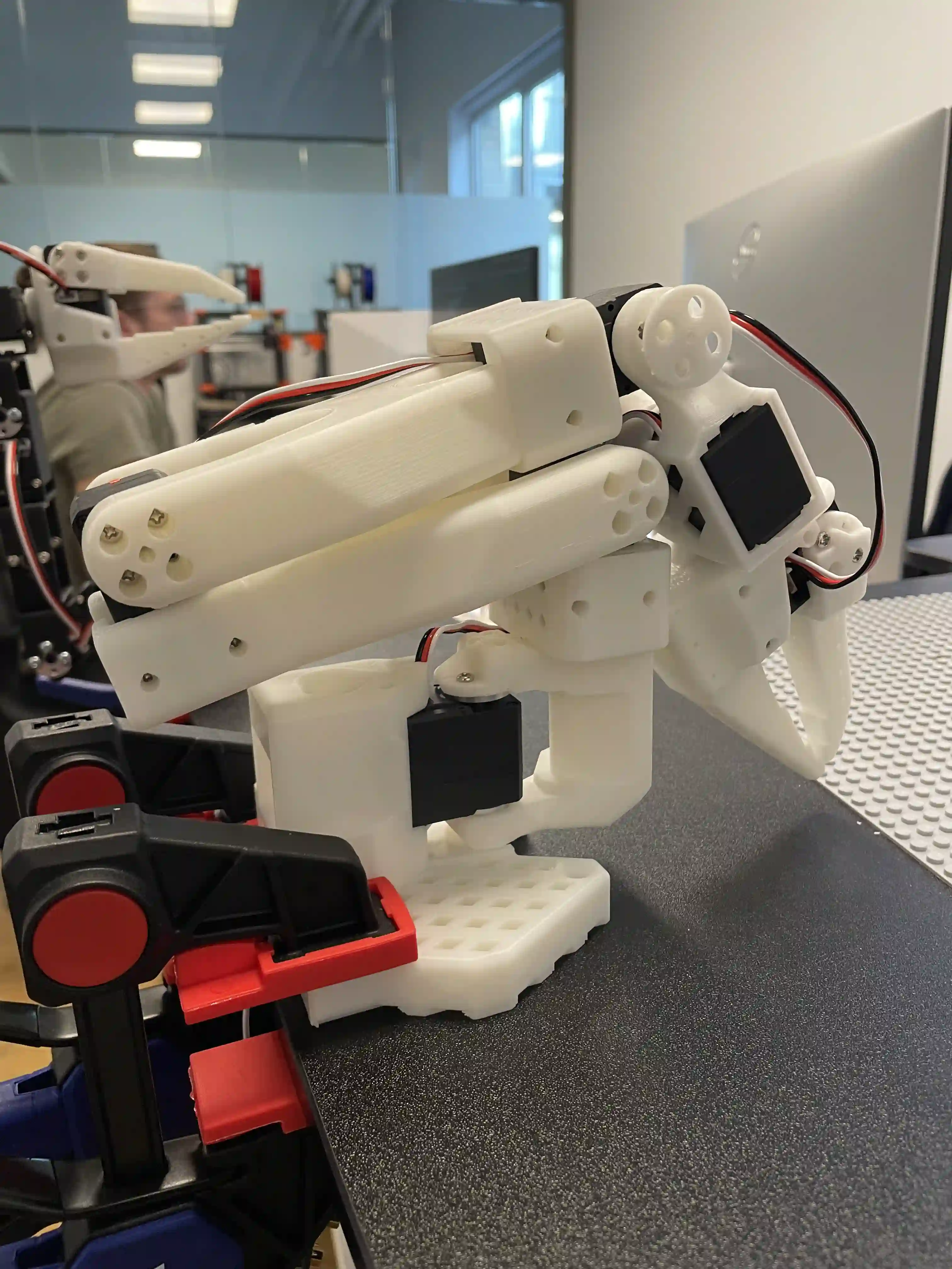

Auto-calibration of follower arm Follow step 5 of the assembly video which illustrates the auto-calibration of the follower arm. You first need to manually move your follower arm to this initial position:
SO-100 follower arm initial position
