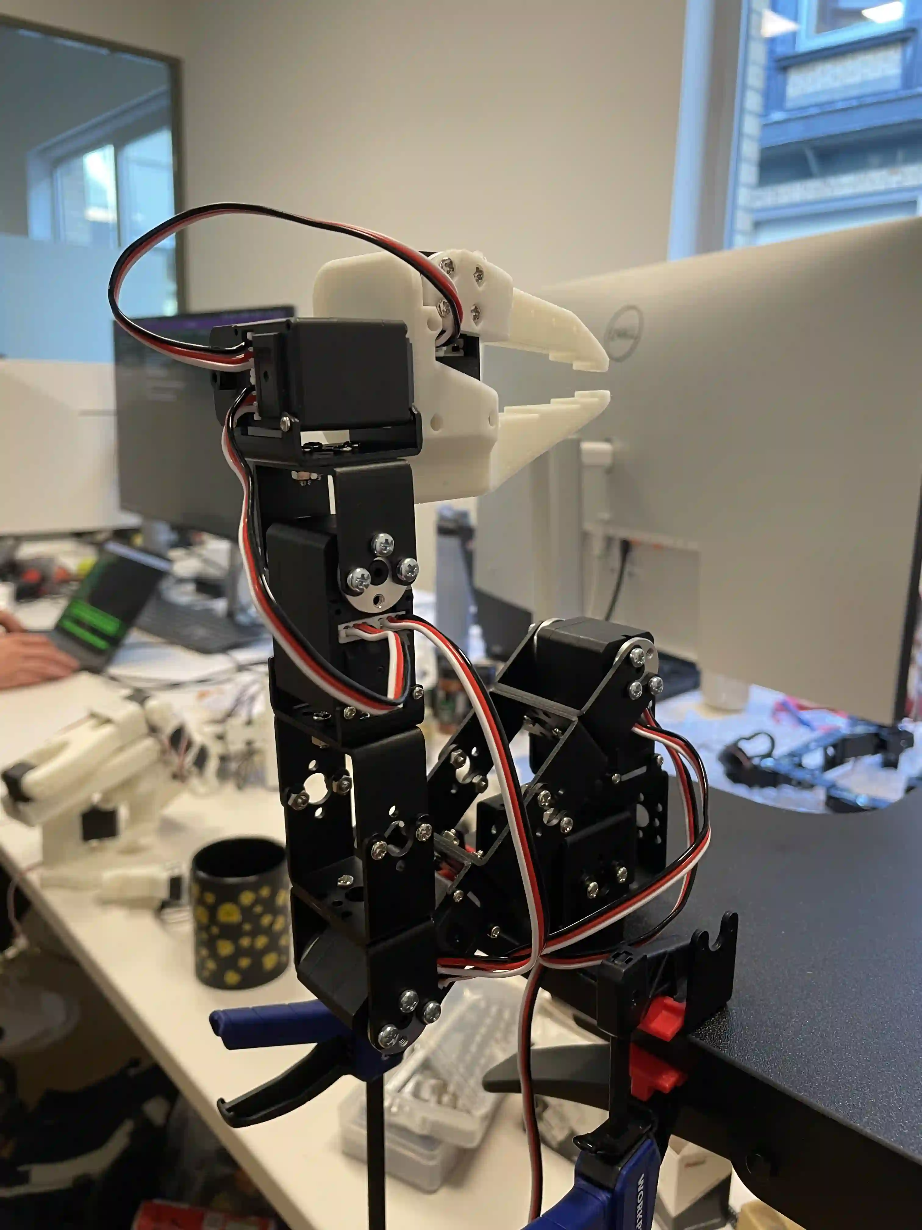

Assemble the arms

Auto-calibration of follower arm Follow step 5 of the assembly video which illustrates the auto-calibration of the follower arm. You first need to manually move your follower arm to this initial position:
Moss v1 follower arm initial position
Then run this script to launch auto-calibration:

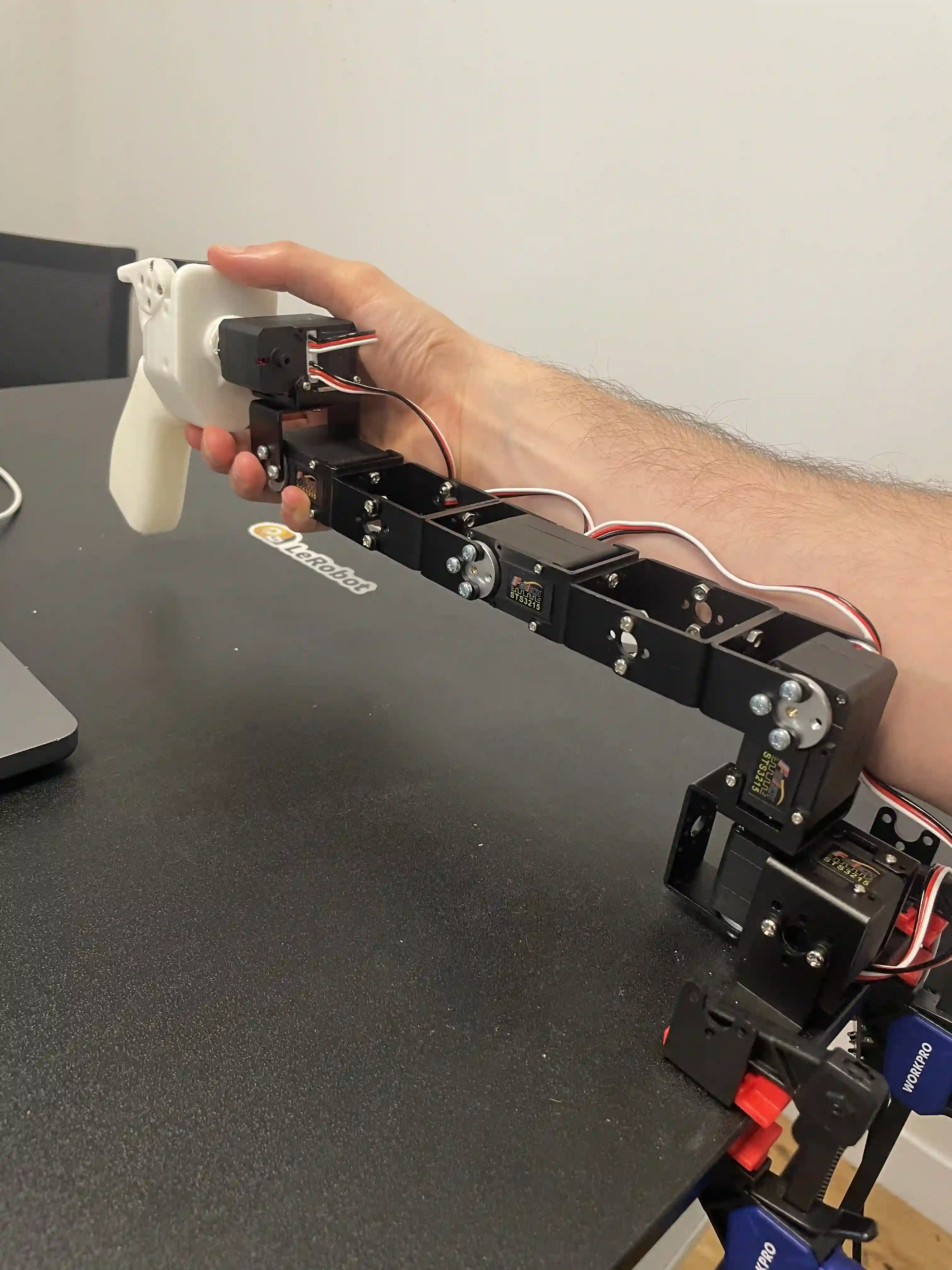

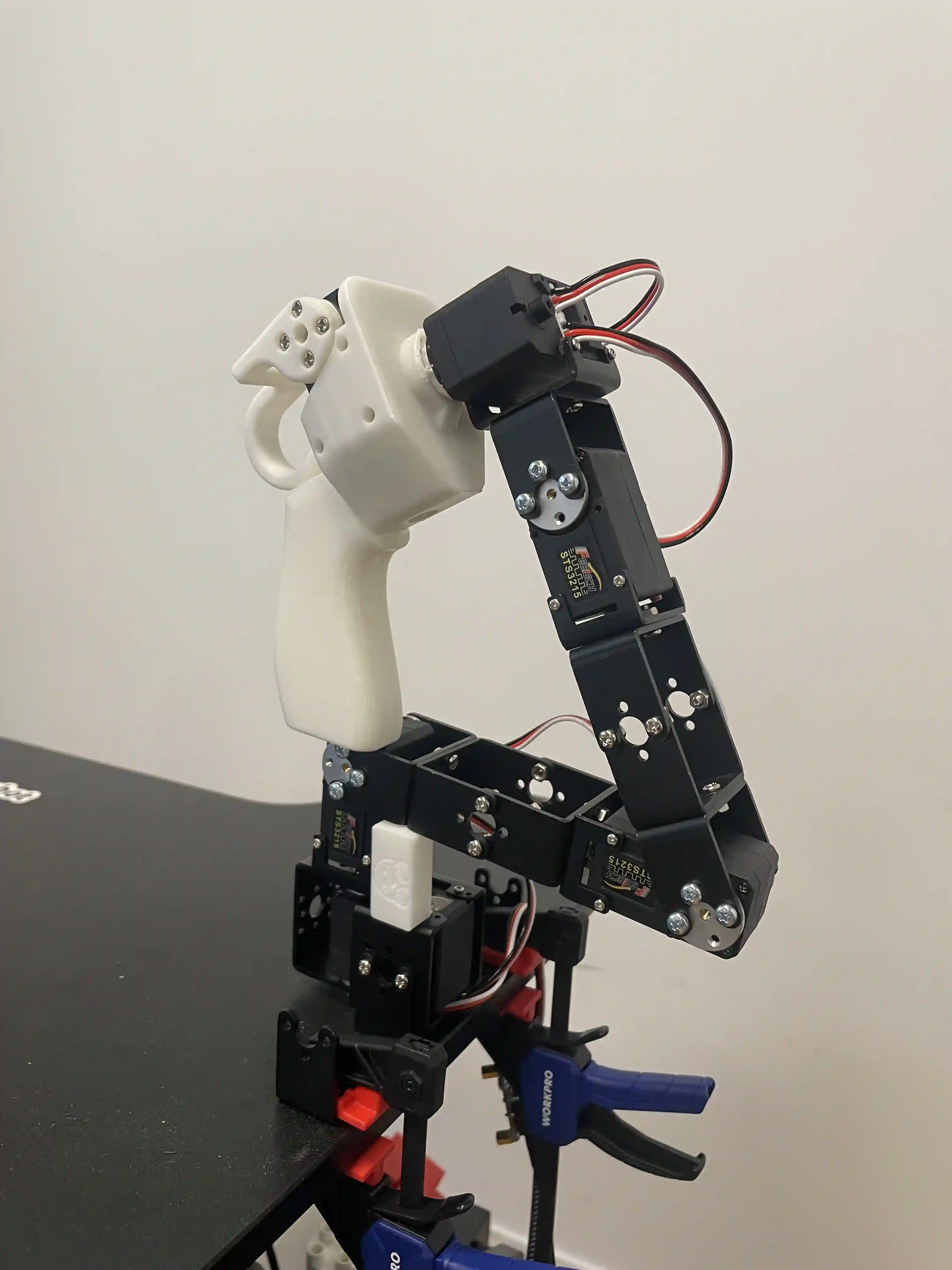

Note: You can't run auto-calibration for the leader arm, since we removed the gears. Thus, you will need to manually calibrate the leader arm. It's less precise than auto-calibration, but precision is not as critical for the leader arm.
    --robot-path lerobot/configs/robot/moss.yaml \

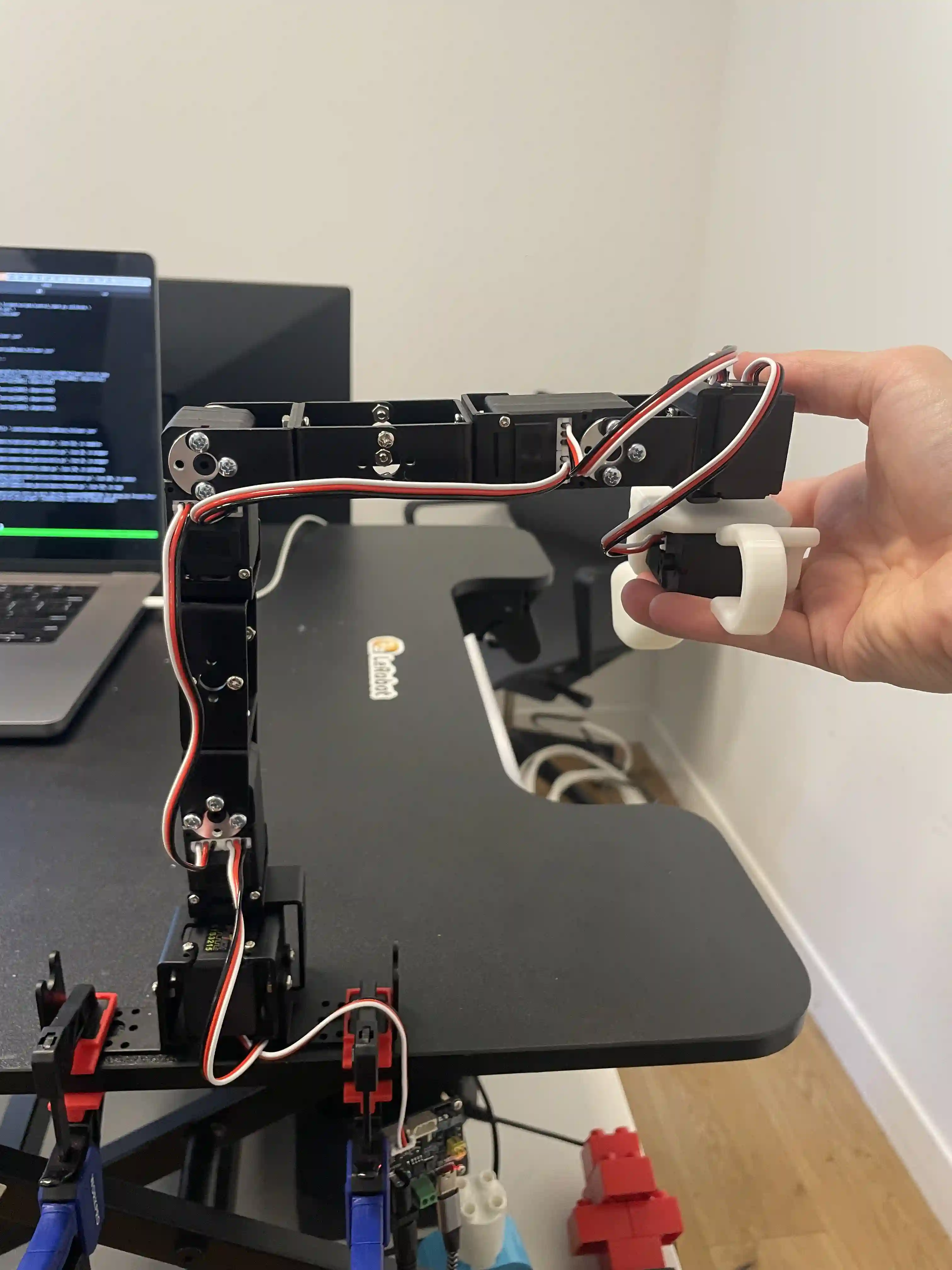

Teleoperate
    --display-cameras 0
