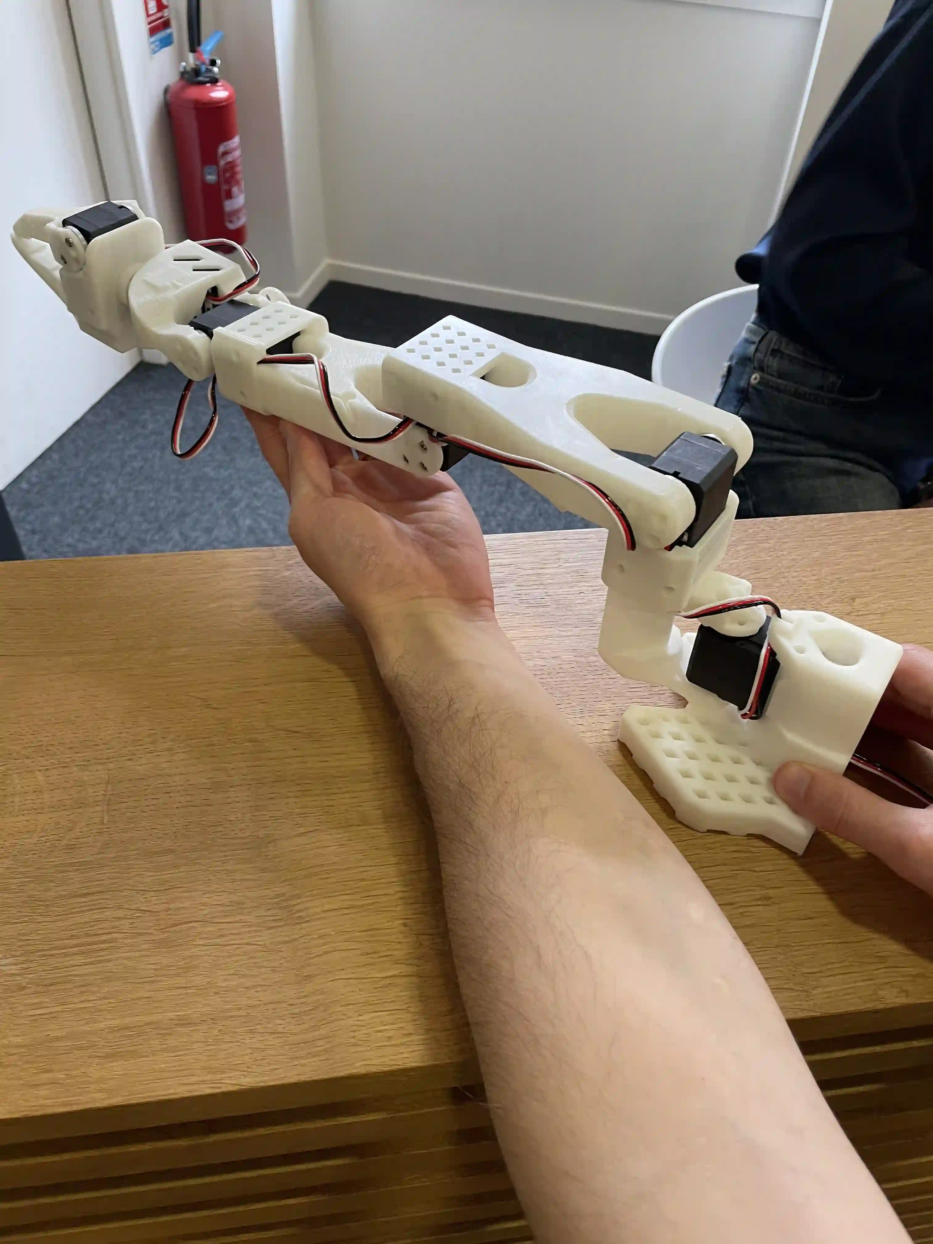

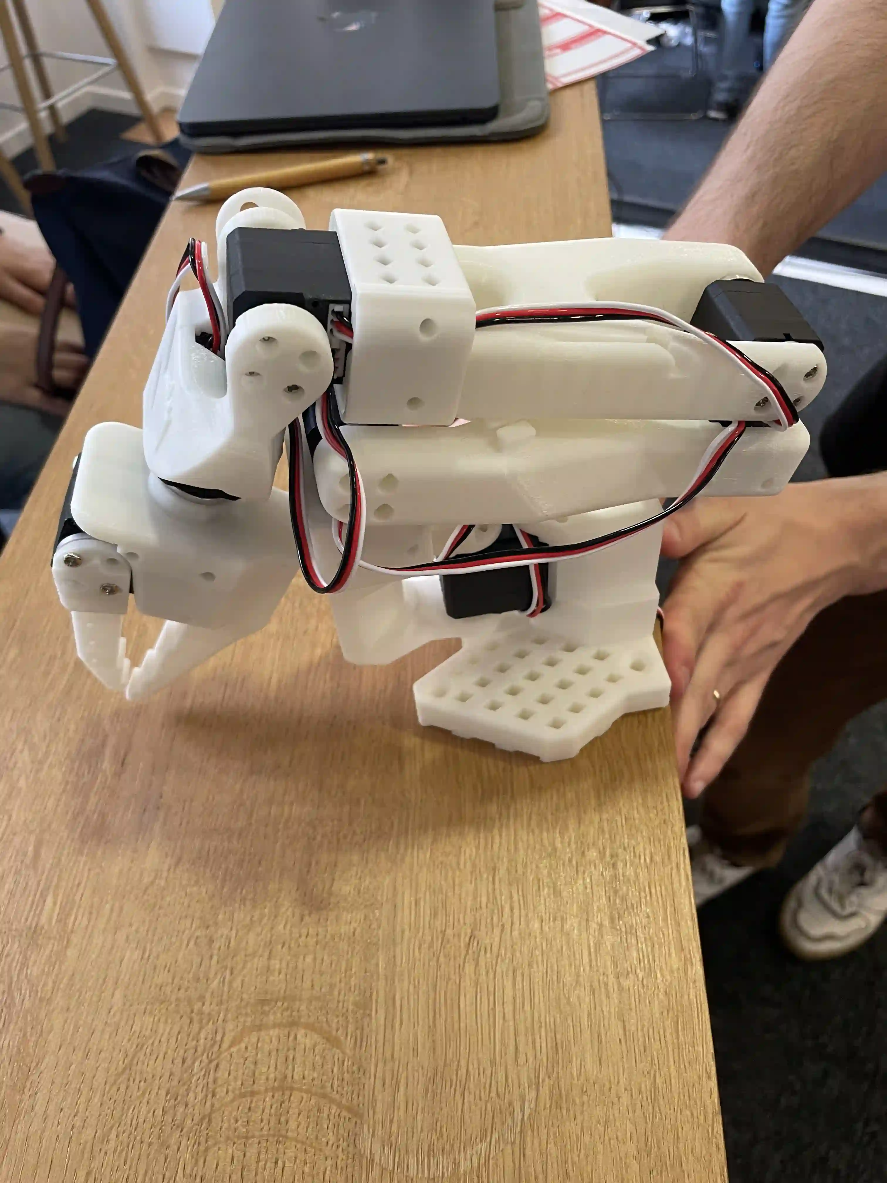

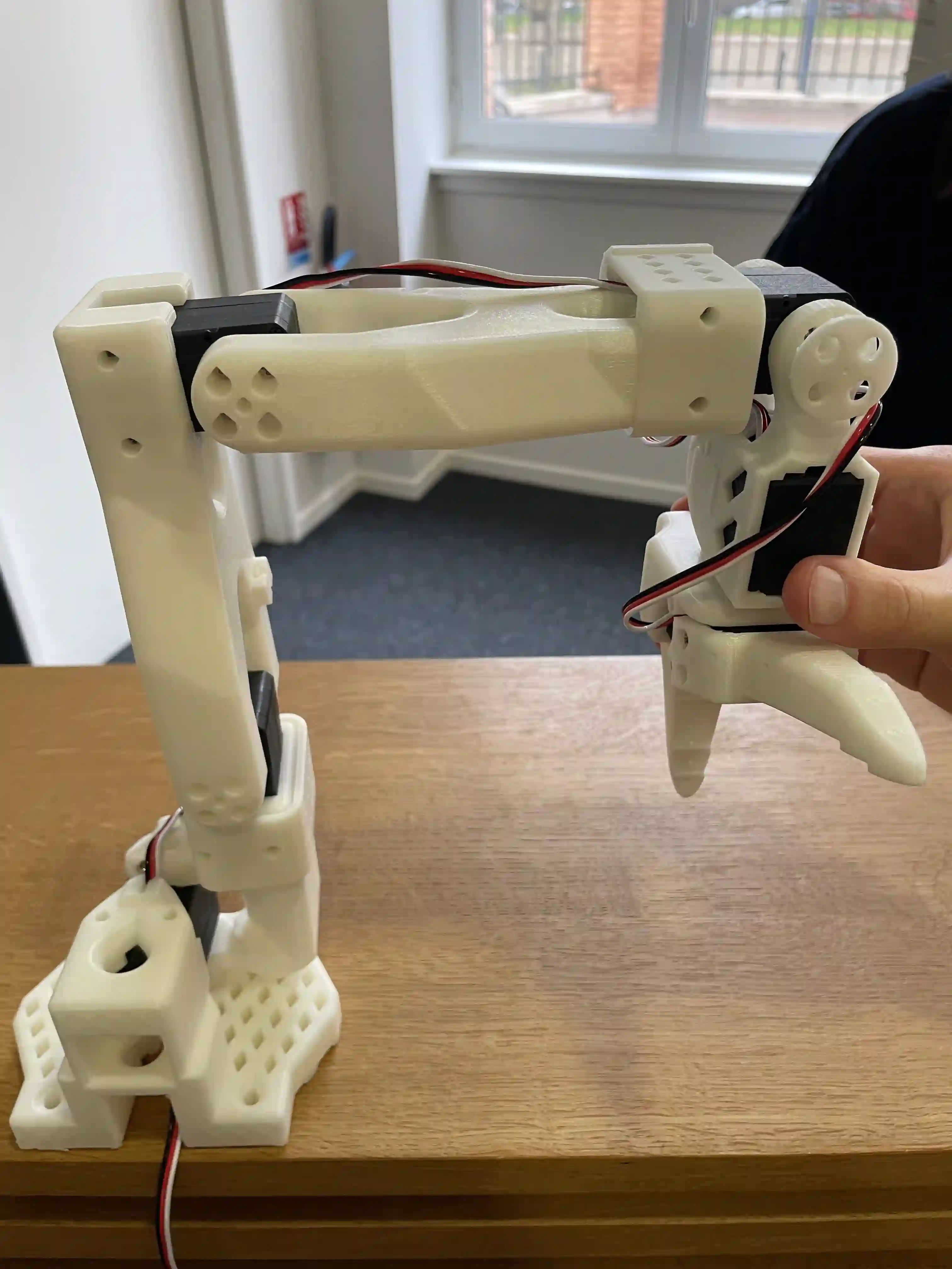

Calibrate
    --robot-path lerobot/configs/robot/moss.yaml \
    --robot-path lerobot/configs/robot/so100.yaml \
