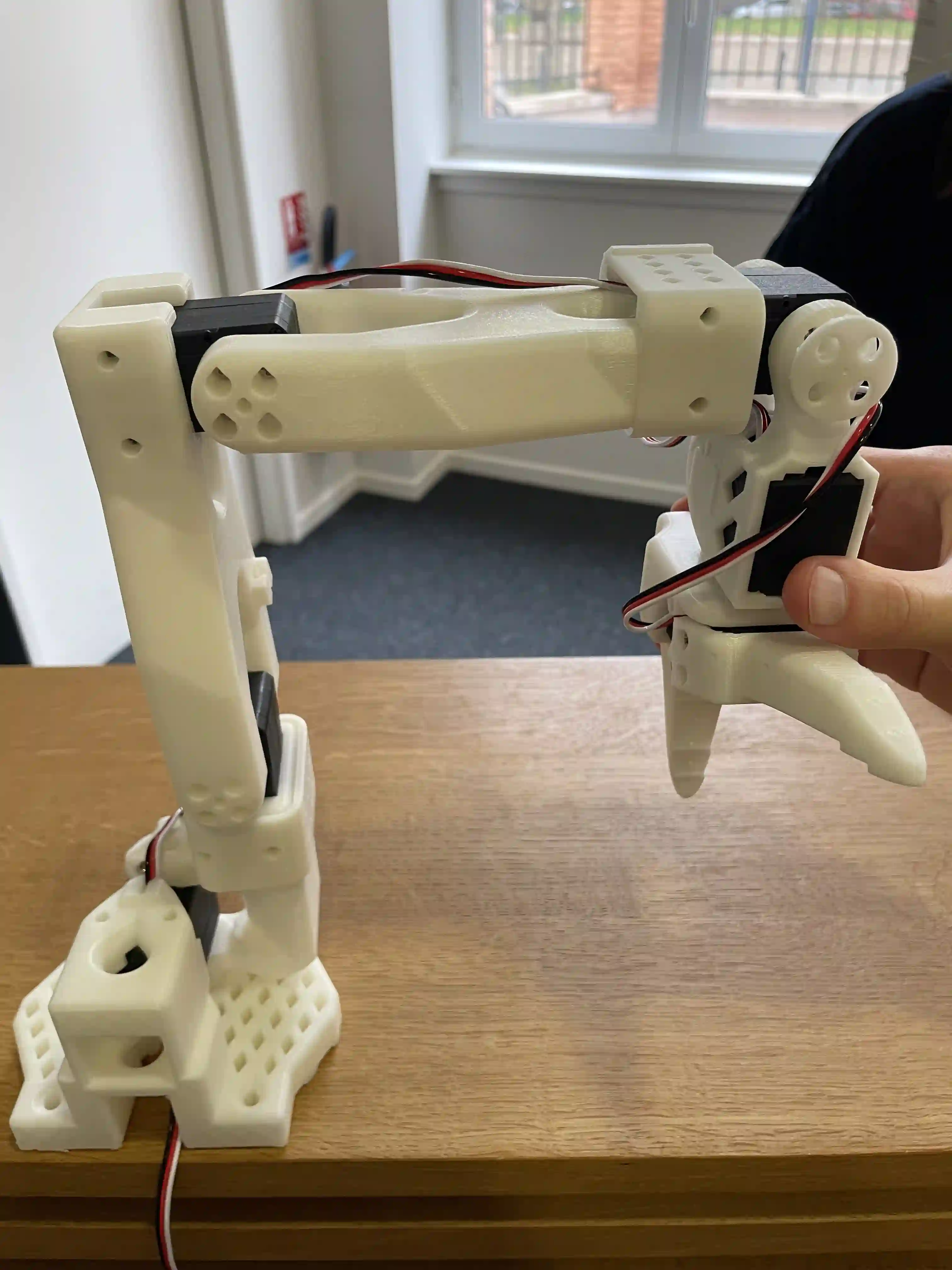

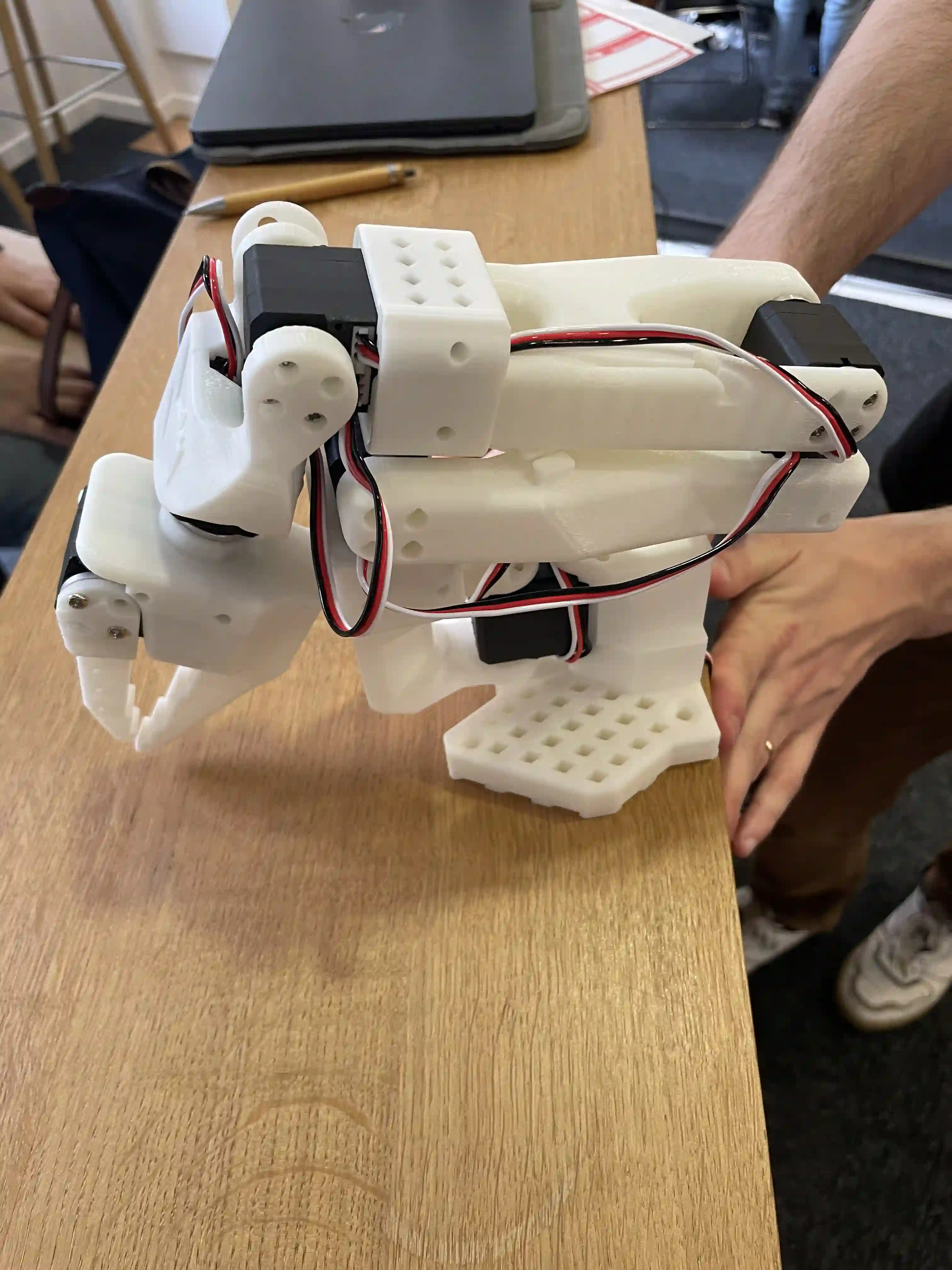

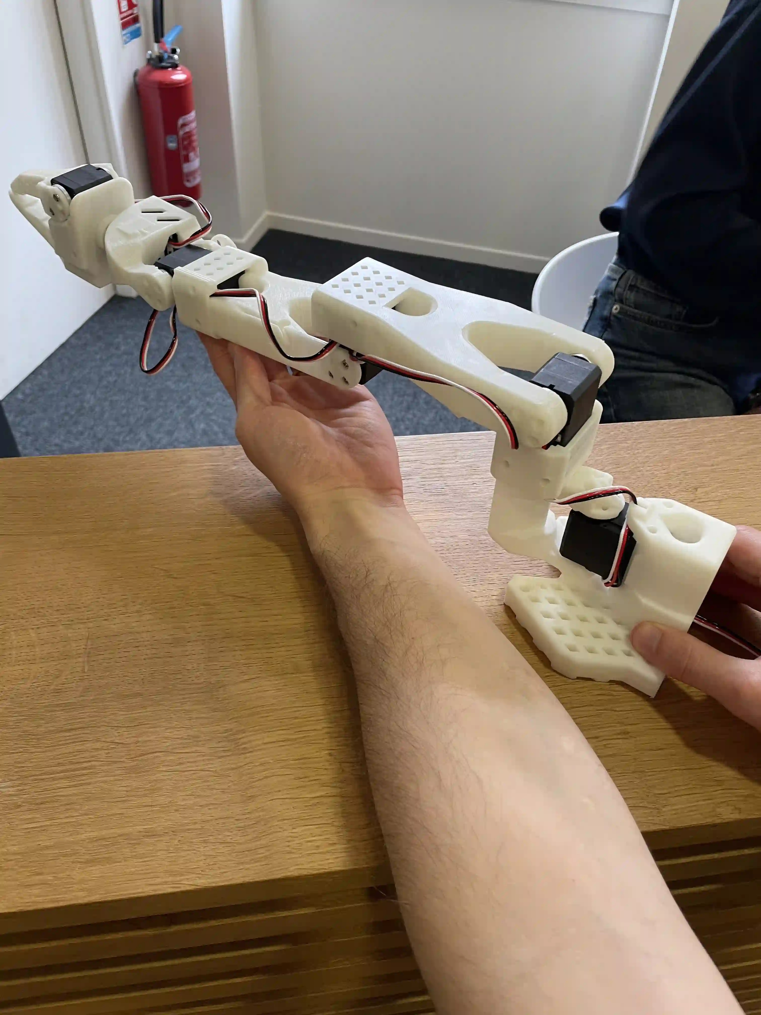

D. Assemble the arms

a. Manual calibration of follower arm
/!\ Contrarily to step 6 of the assembly video which illustrates the auto calibration, we will actually do manual calibration of follower for now.
  --robot.type=so100 \
  --robot.cameras='{}' \
  --control.type=calibrate \
b. Manual calibration of leader arm
Follow step 6 of the assembly video which illustrates the manual calibration. You will need to move the leader arm to these positions sequentially:
