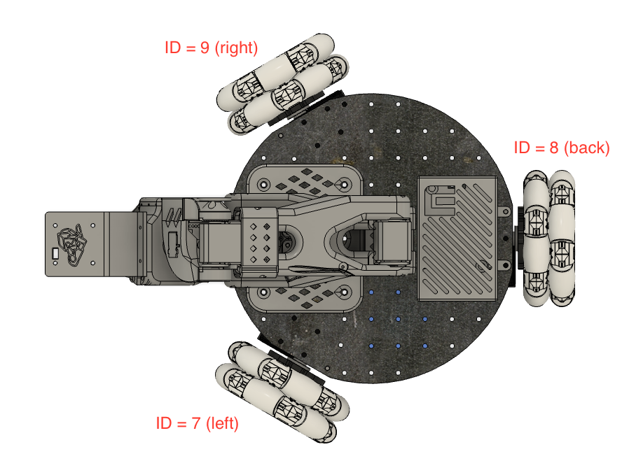

Motor ID's for mobile robot

                    "left_wheel": (7, "sts3215"),
                    "back_wheel": (8, "sts3215"),
