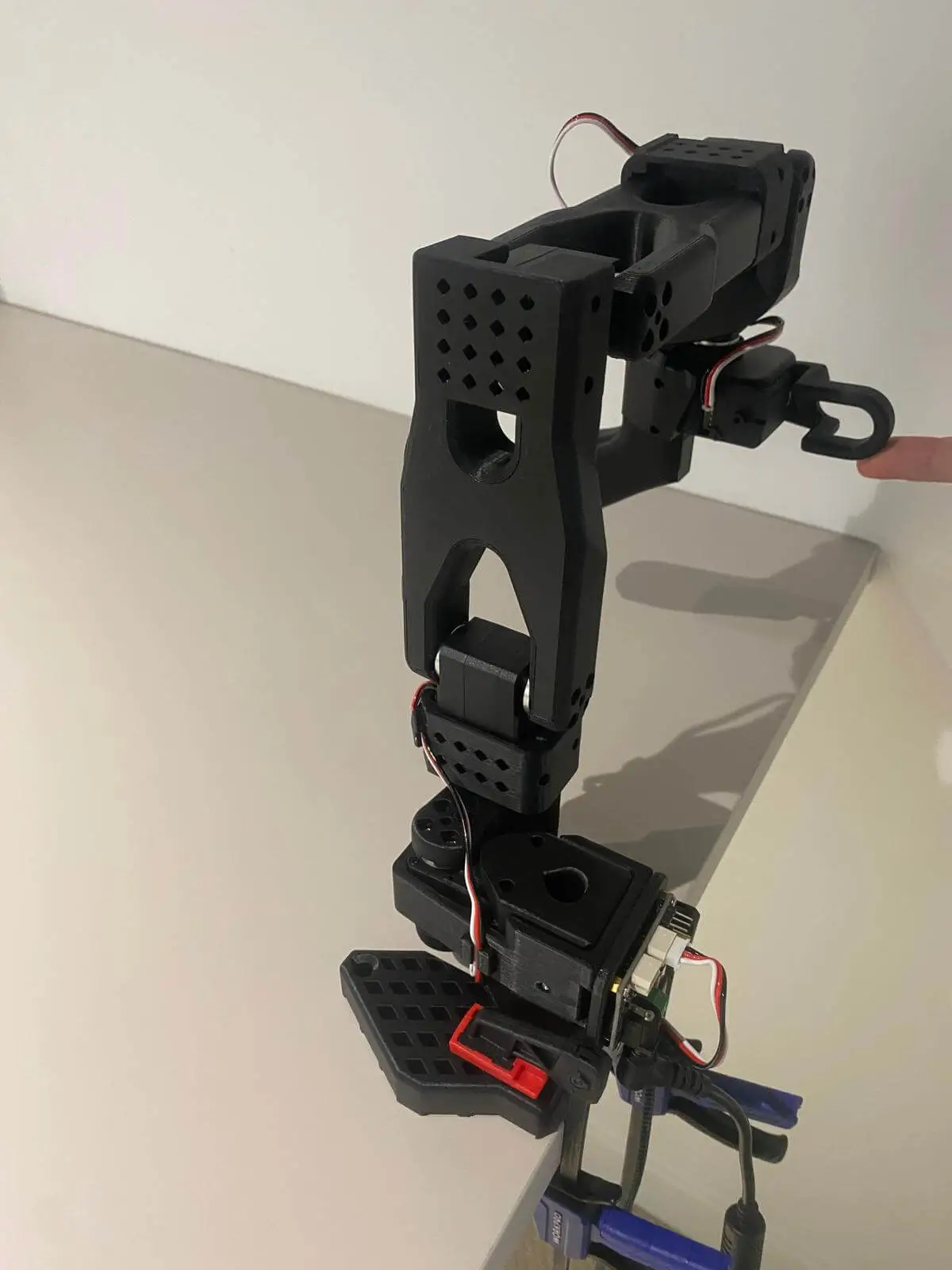

Step-by-Step Assembly Instructions
Clean Parts
Remove all support material from the 3D-printed parts.
Joint 1
  • Fasten the motor with 4 M2x6mm screws (smallest screws). Two from the top and two from bottom.
  • Slide over the first motor holder and fasten it using two M2x6mm screws (one on each side).
  • Install both motor horns, securing the top horn with a M3x6mm screw.
  • Attach the shoulder part.
  • Tighten the shoulder part with 4 M3x6mm screws on top and 4 M3x6mm screws on the bottom
Joint 2
  • Slide the second motor in from the top.
  • Fasten the second motor with 4 M2x6mm screws.
  • Attach both motor horns to motor 2, again use the M3x6mm horn screw.
  • Attach the upper arm with 4 M3x6mm screws on each side.
Joint 3
  • Insert motor 3 and fasten using 4 M2x6mm screws
  • Attach both motor horns to motor 3 and secure one again with a M3x6mm horn screw.
  • Connect the forearm to motor 3 using 4 M3x6mm screws on each side.
Joint 4
  • Slide over motor holder 4.
  • Slide in motor 4.
  • Fasten motor 4 with 4 M2x6mm screws and attach its motor horns, use a M3x6mm horn screw.
Joint 5
  • Insert motor 5 into the wrist holder and secure it with 2 M2x6mm front screws.
  • Install only one motor horn on the wrist motor and secure it with a M3x6mm horn screw.
  • Secure the wrist to motor 4 using 4 M3x6mm screws on both sides.

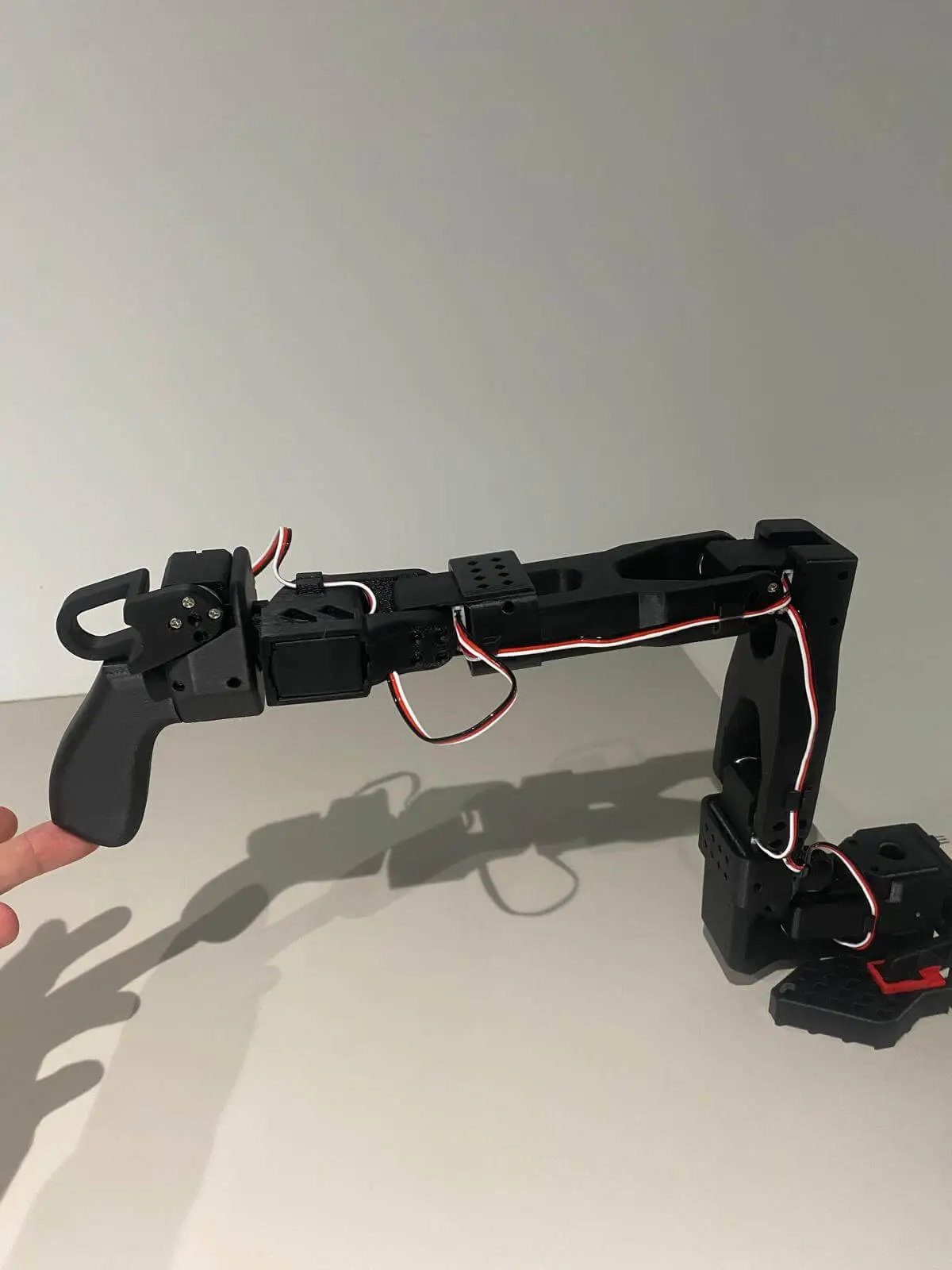

Gripper / Handle
Follower:
  • Attach the gripper to motor 5, attach it to the motor horn on the wrist using 4 M3x6mm screws.
  • Insert the gripper motor and secure it with 2 M2x6mm screws on each side.
  • Attach the motor horns and again use a M3x6mm horn screw.
  • Install the gripper claw and secure it with 4 M3x6mm screws on both sides.
Leader:
  • Mount the leader holder onto the wrist and secure it with 4 M3x6mm screws.
  • Attach the handle to motor 5 using 1 M2x6mm screw.
  • Insert the gripper motor, secure it with 2 M2x6mm screws on each side, attach a motor horn using a M3x6mm horn screw.
  • Attach the follower trigger with 4 M3x6mm screws.

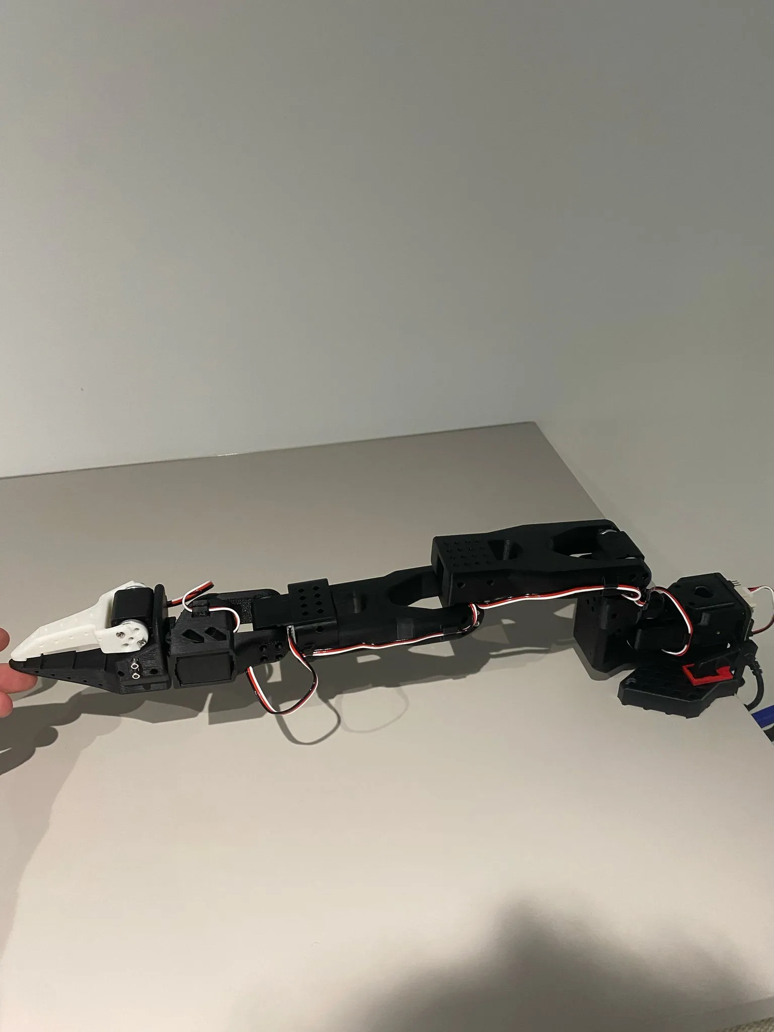

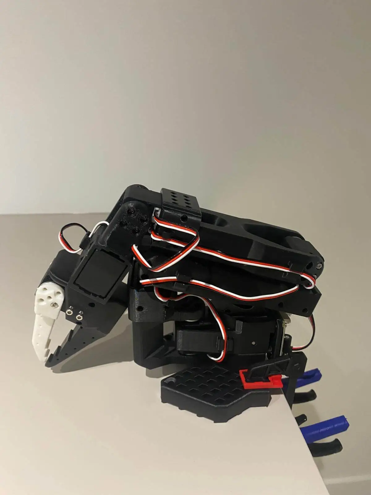

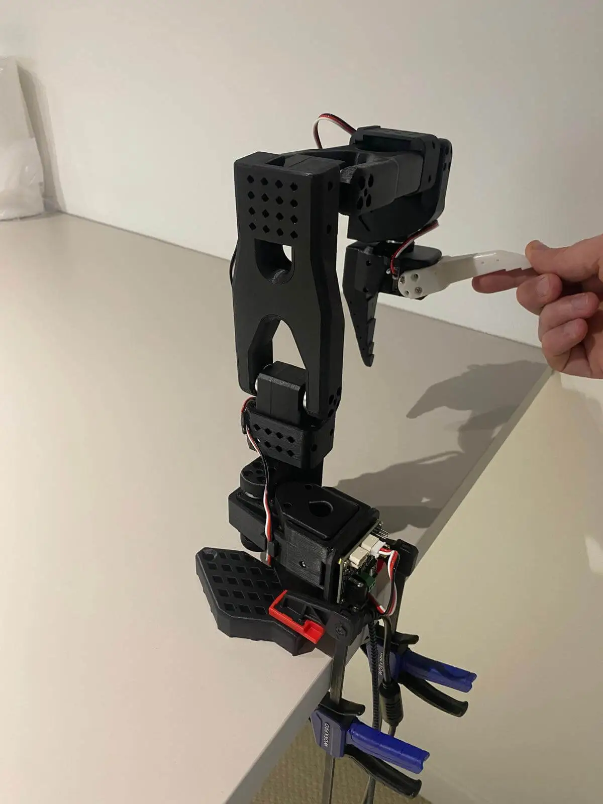

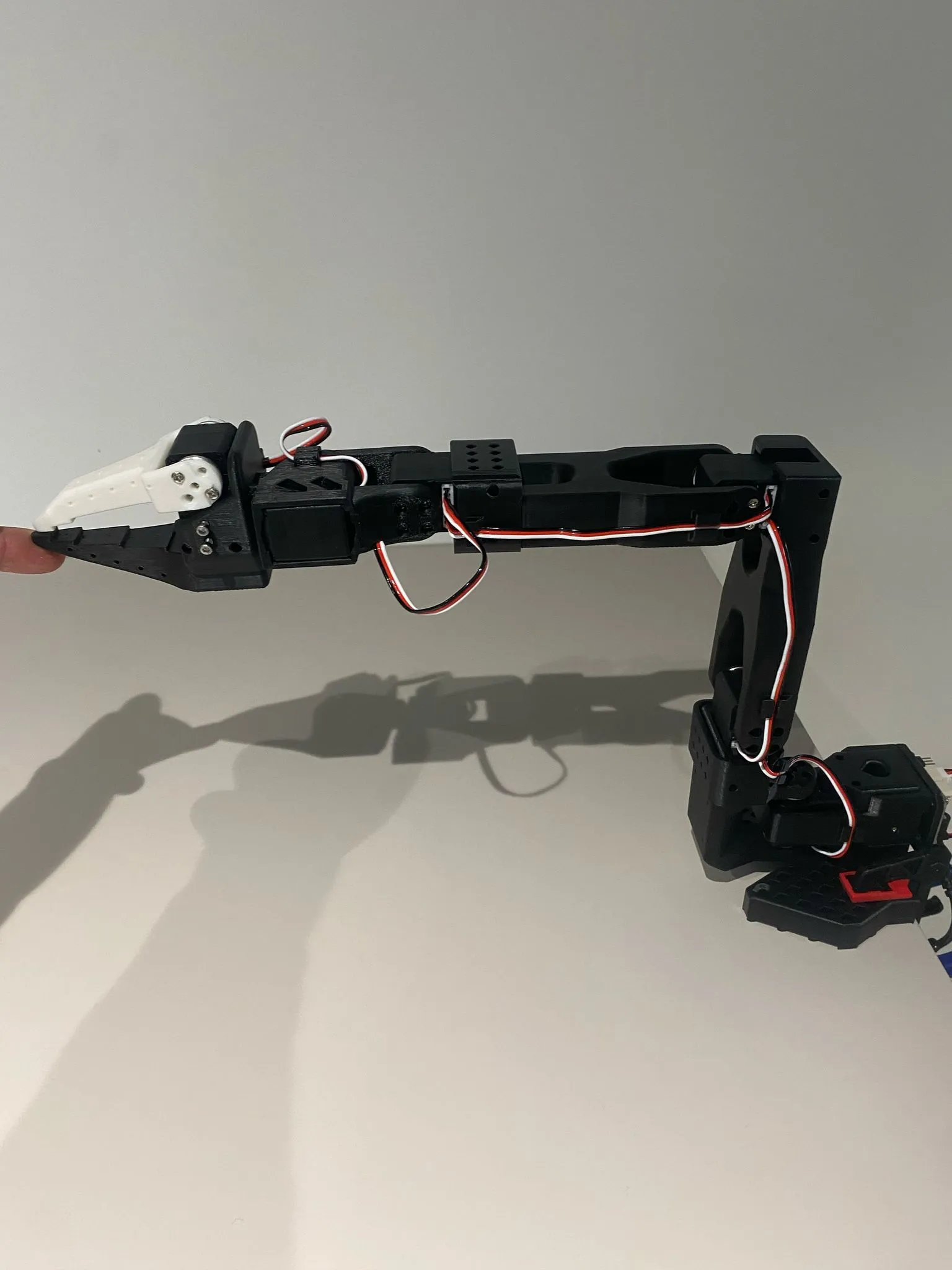

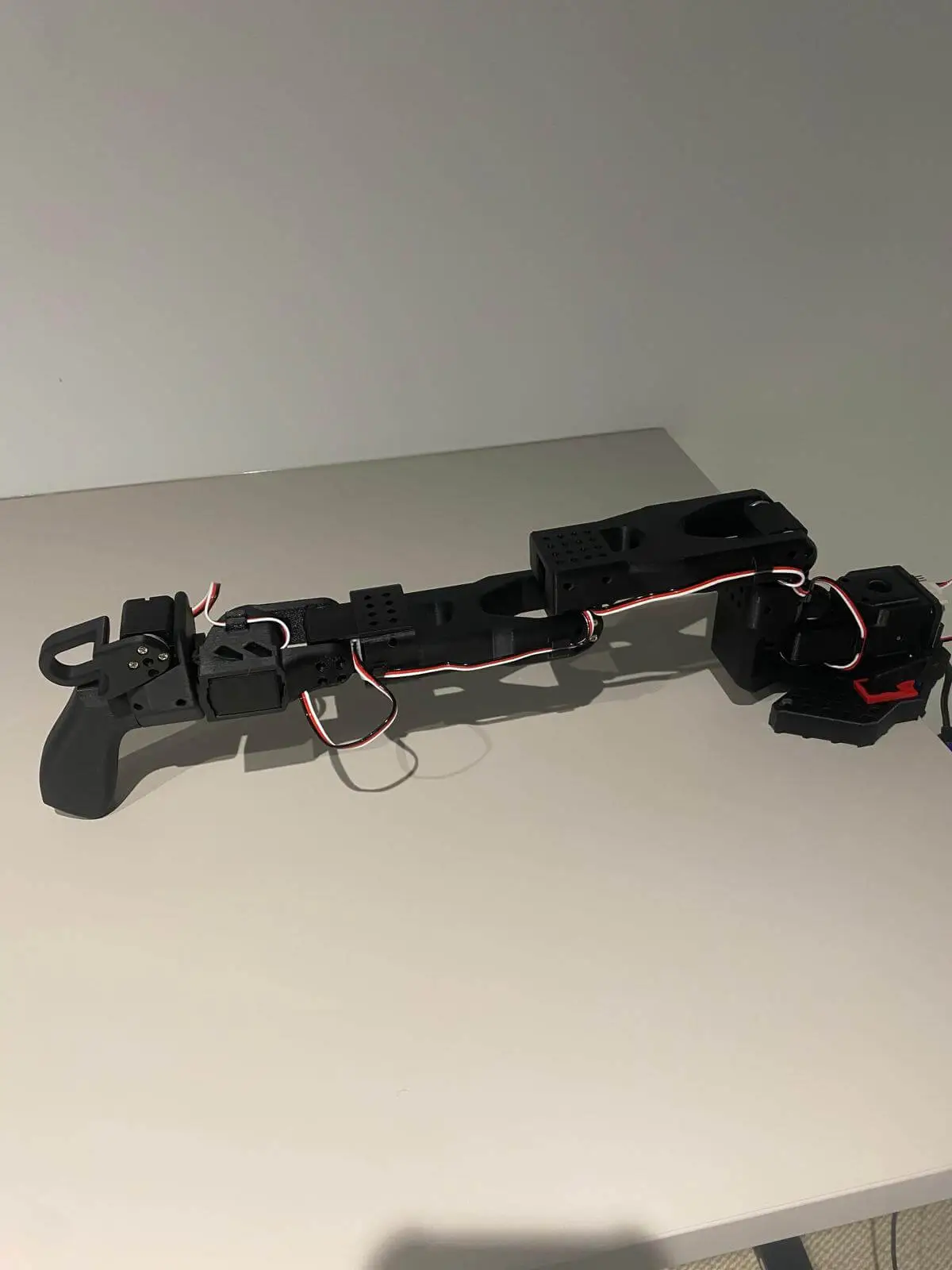

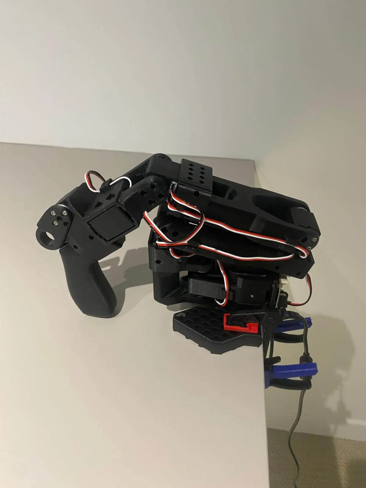

1. Middle position 2. Zero position 3. Rotated position 4. Rest position
SO-101 leader arm middle position SO-101 leader arm zero position SO-101 leader arm rotated position SO-101 leader arm rest position
