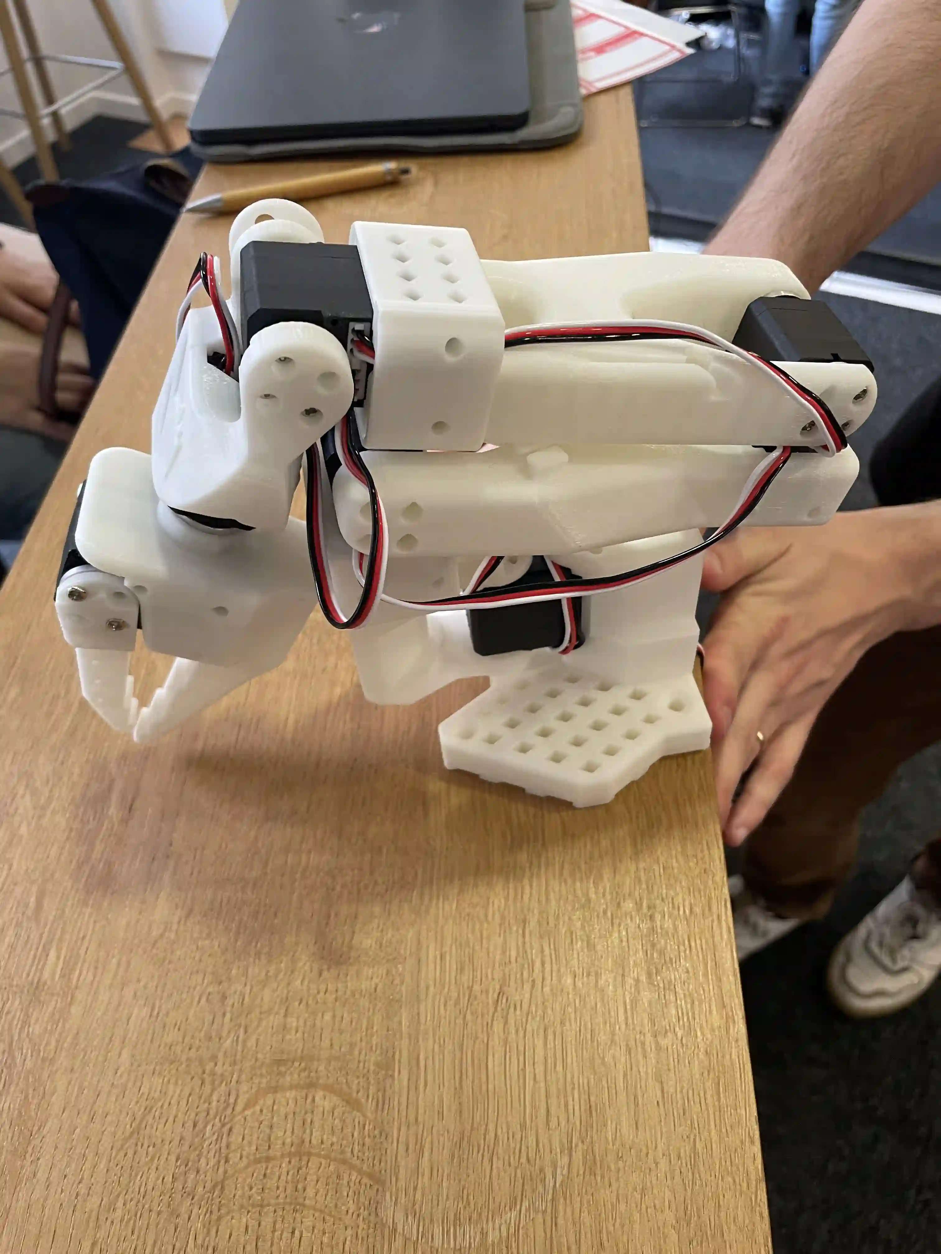

Follow the video for removing gears. You need to remove the gear for the motors of the leader arm. As a result, you will only use the position encoding of the motor and reduce friction to more easily operate the leader arm.

Step 27: Mount Controller
Assembly complete proceed to Leader arm assembly.
