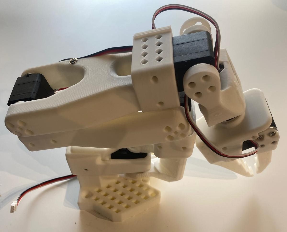

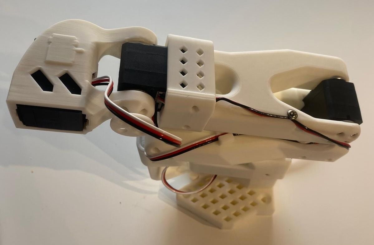

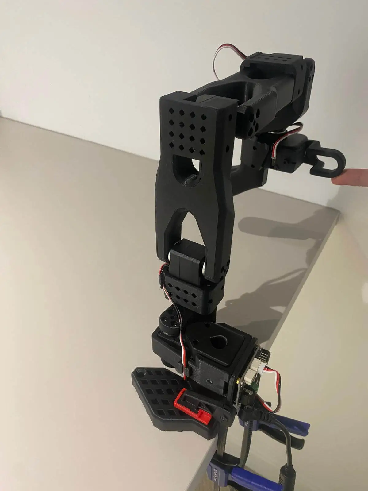

D. Step-by-Step Assembly Instructions
Step 1: Clean Parts
  • Remove all support material from the 3D-printed parts.
Additional Guidance
Video assembling arms
Note: This video provides visual guidance for assembling the arms, but it doesn't specify when or how to do the wiring. Inserting the cables beforehand is much easier than doing it afterward. The first arm may take a bit more than 1 hour to assemble, but once you get used to it, you can assemble the second arm in under 1 hour.

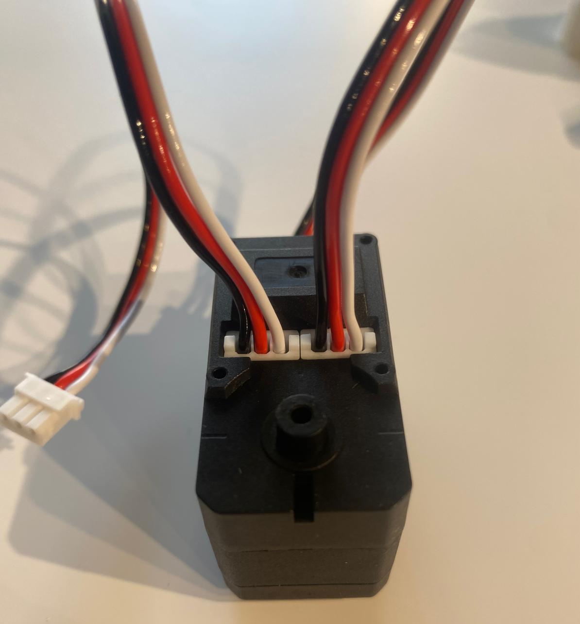

Step 2: Insert Wires
  • Insert two wires into the first motor.

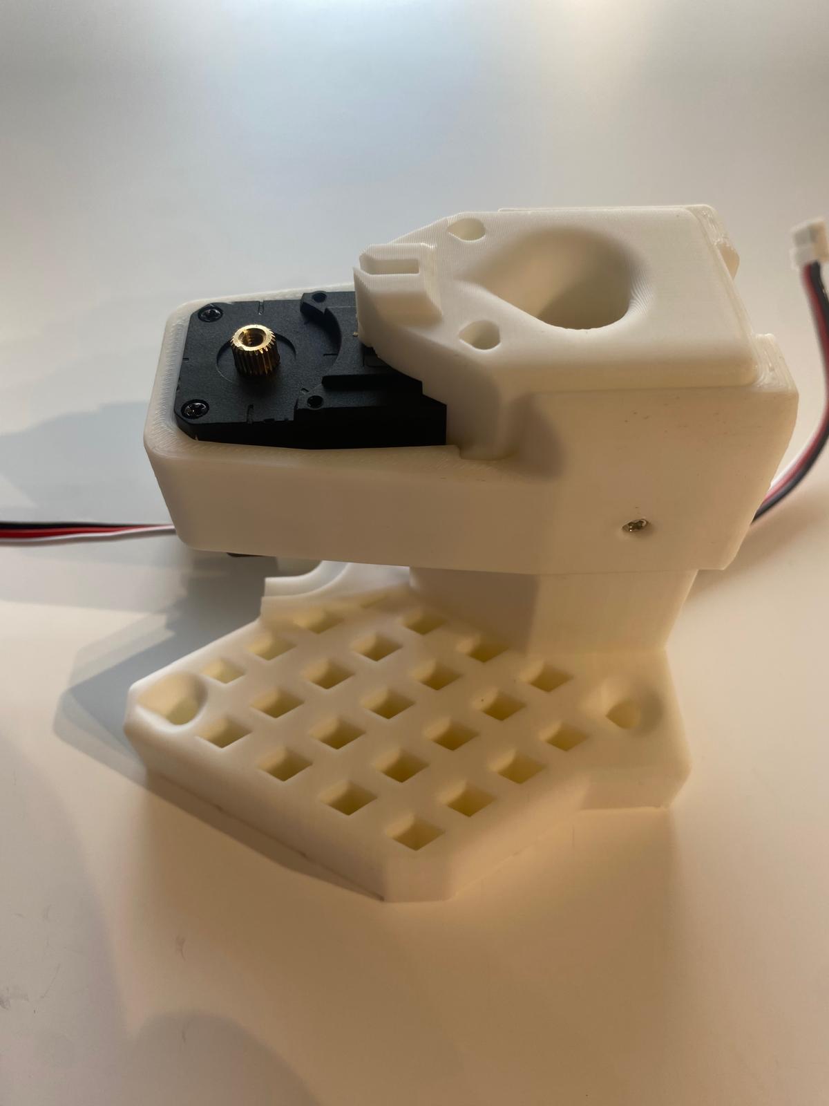

Step 3: Install in Base
Step 4: Secure Motor
  • Fasten the motor with 4 screws. Two from the bottom and two from top.
Step 5: Attach Motor Holder

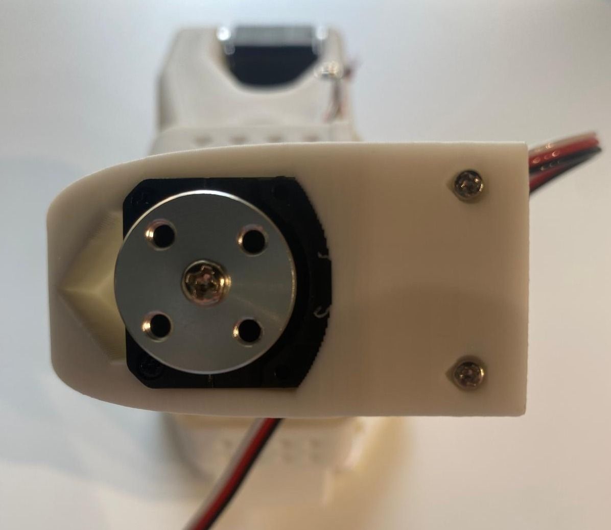

  • Slide over the first motor holder and fasten it using two screws (one on each side).
Step 6: Attach Motor Horns
  • Install both motor horns, securing the top horn with a screw. Try not to move the motor position when attaching the motor horn, especially for the leader arms, where we removed the gears.
Video adding motor horn
Step 7: Attach Shoulder Part

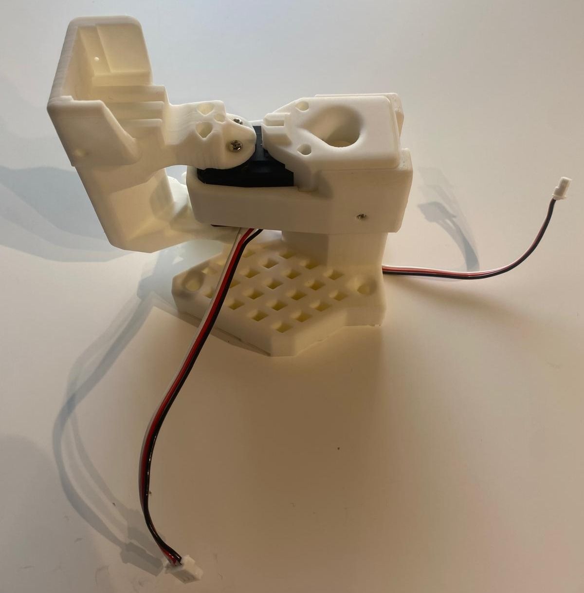

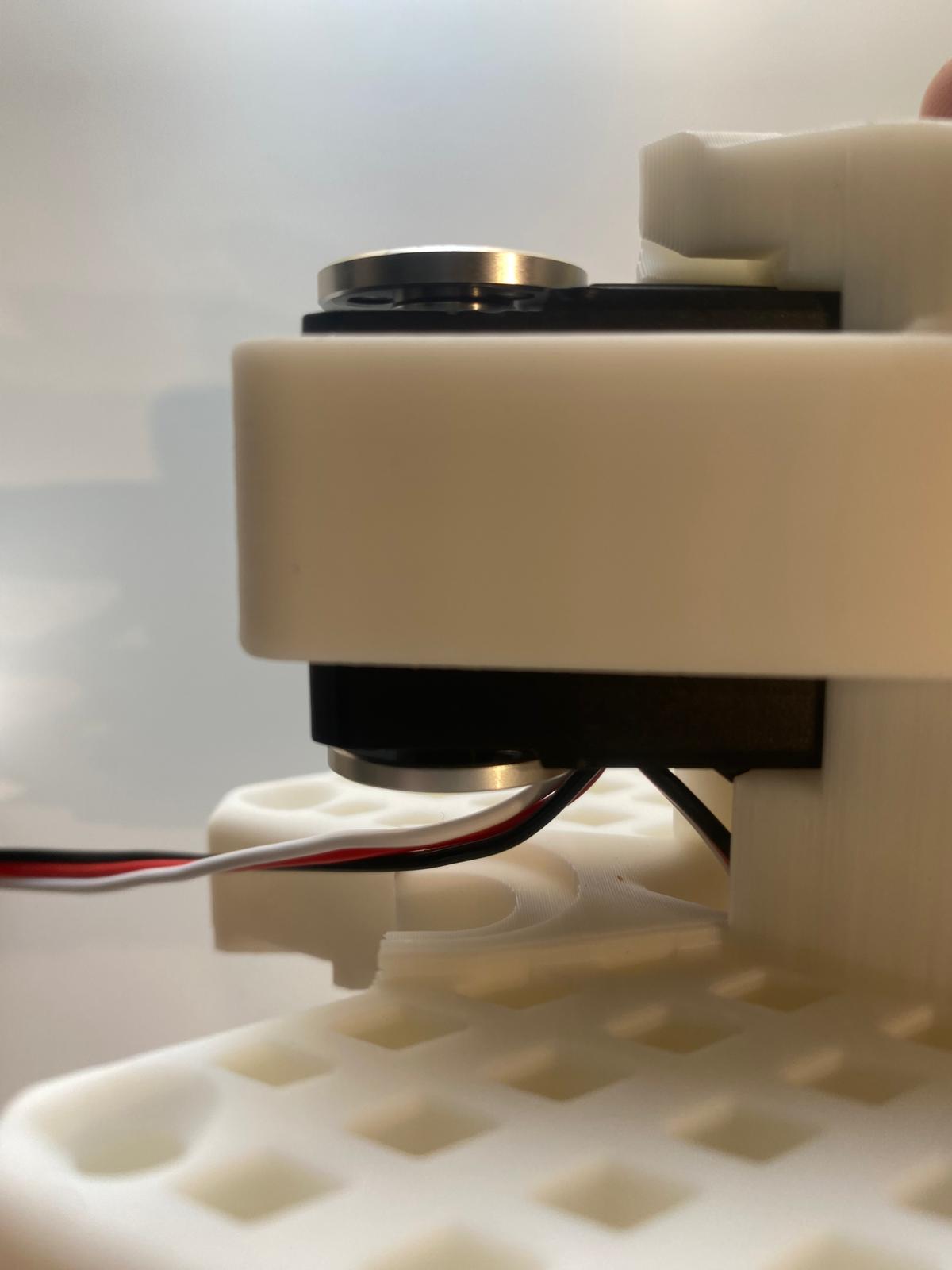

  • Route one wire to the back of the robot and the other to the left or in photo towards you (see photo).
  • Attach the shoulder part.
Step 8: Secure Shoulder
  • Tighten the shoulder part with 4 screws on top and 4 on the bottom (access bottom holes by turning the shoulder).

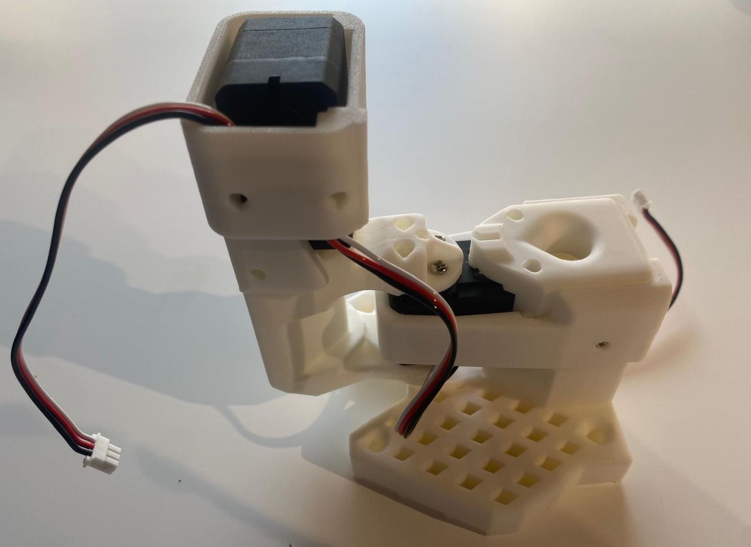

Step 9: Install Motor 2
  • Slide the second motor in from the top and link the wire from motor 1 to motor 2.

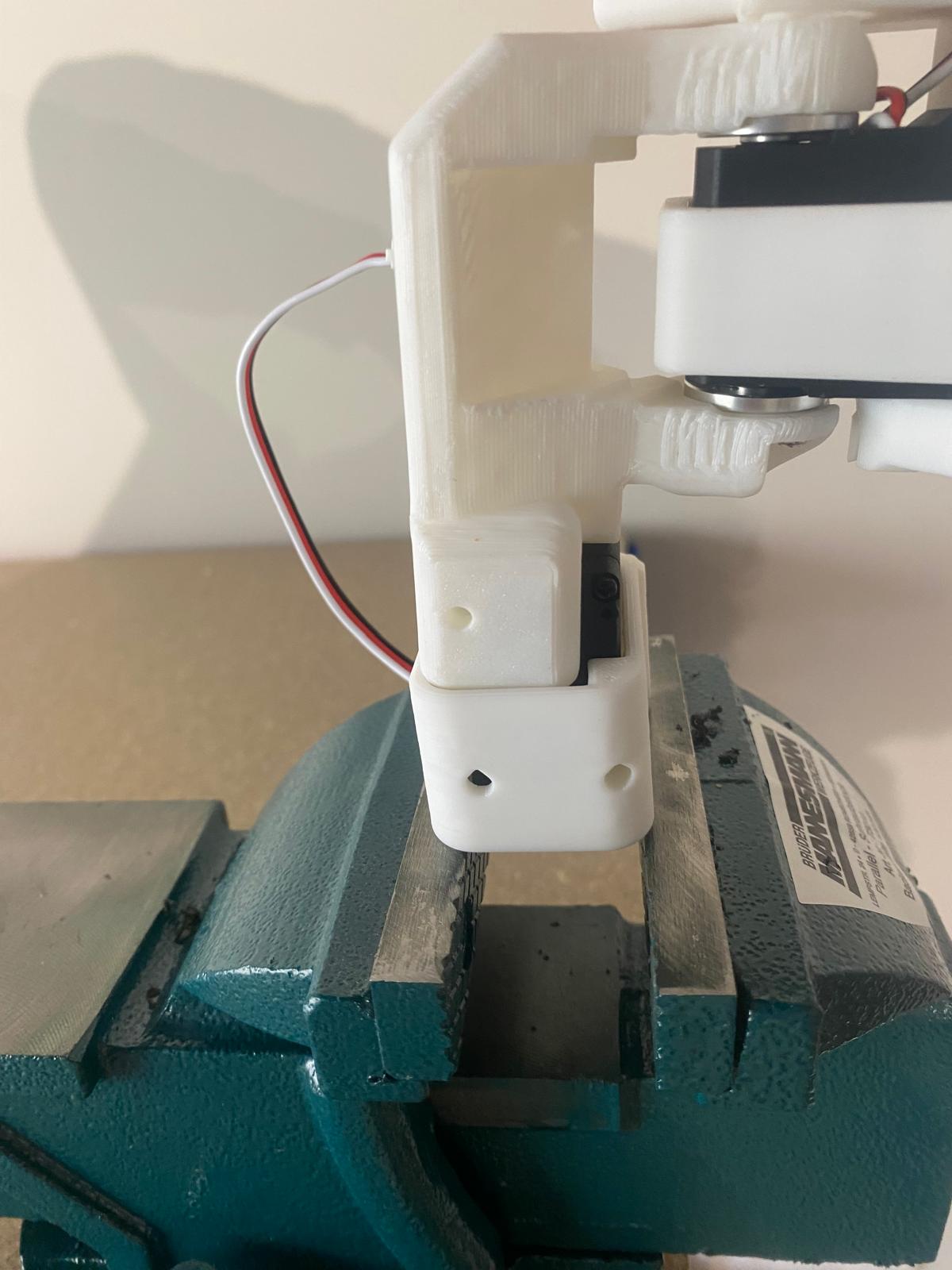

Step 10: Attach Shoulder Holder
  • Ensure the wire from motor 1 to motor 2 goes behind the holder while the other wire is routed upward (see photo).
  • This part can be tight to assemble, you can use a workbench like the image or a similar setup to push the part around the motor.

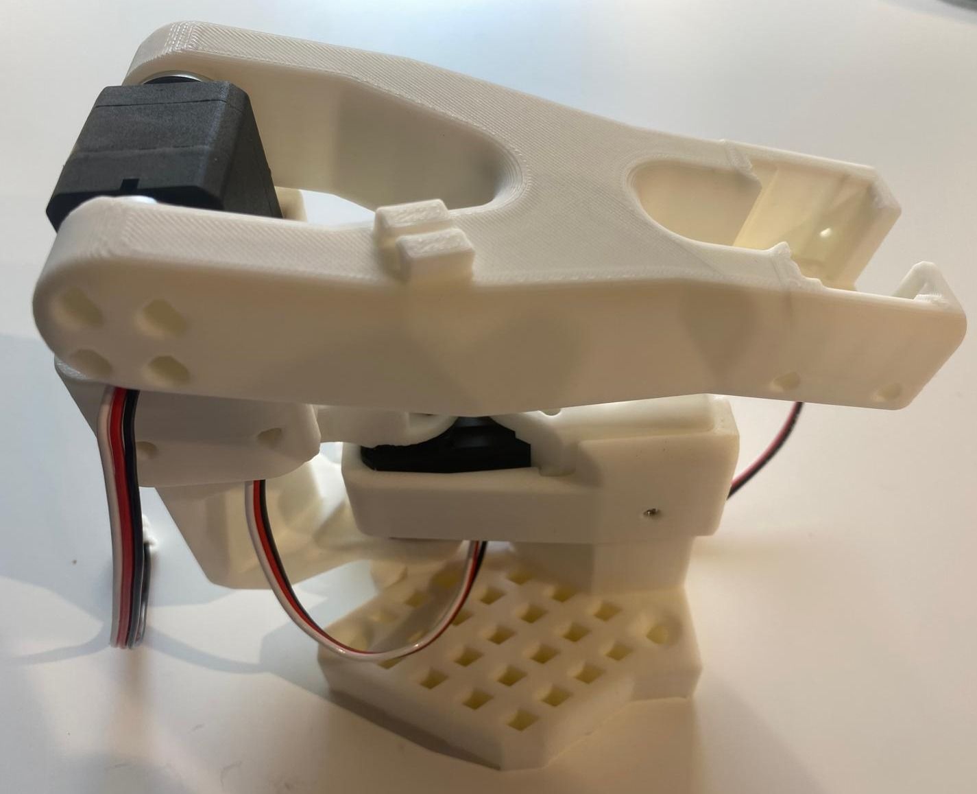

Step 14: Attach Upper Arm

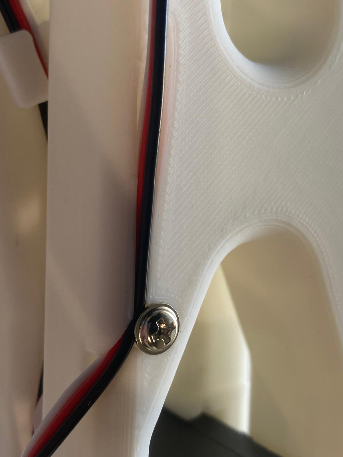

  • Attach the upper arm with 4 screws on each side.
Third Motor Assembly

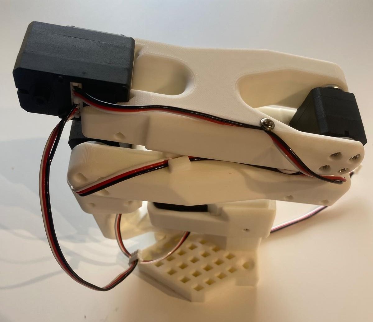

Step 15: Install Motor 3
  • Route the motor cable from motor 2 through the cable holder to motor 3, then secure motor 3 with 4 screws.
Step 16: Attach Motor Horn
  • Attach both motor horns to motor 3 and secure one again with a horn screw.

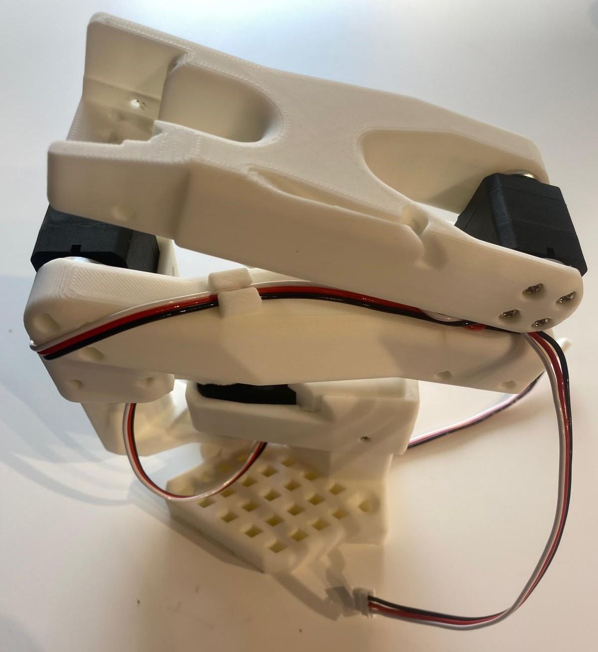

Step 17: Attach Forearm
  • Connect the forearm to motor 3 using 4 screws on each side.
Fourth Motor Assembly
Step 18: Install Motor 4
  • Slide in motor 4, attach the cable from motor 3, and secure the cable in its holder with a screw.

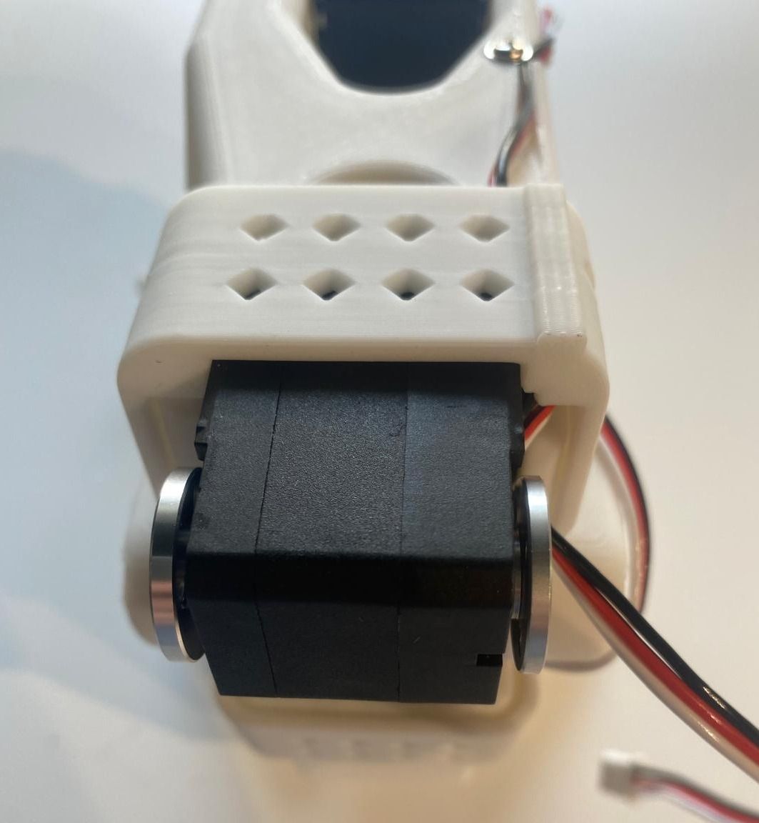

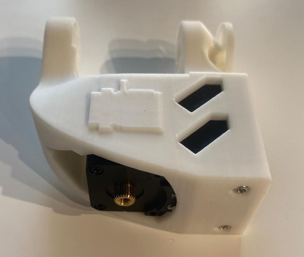

Step 19: Attach Motor Holder 4
  • Install the fourth motor holder (a tight fit). Ensure one wire is routed upward and the wire from motor 3 is routed downward (see photo).
Step 20: Secure Motor 4 & Attach Horn
  • Fasten motor 4 with 4 screws and attach its motor horns, use for one a horn screw.

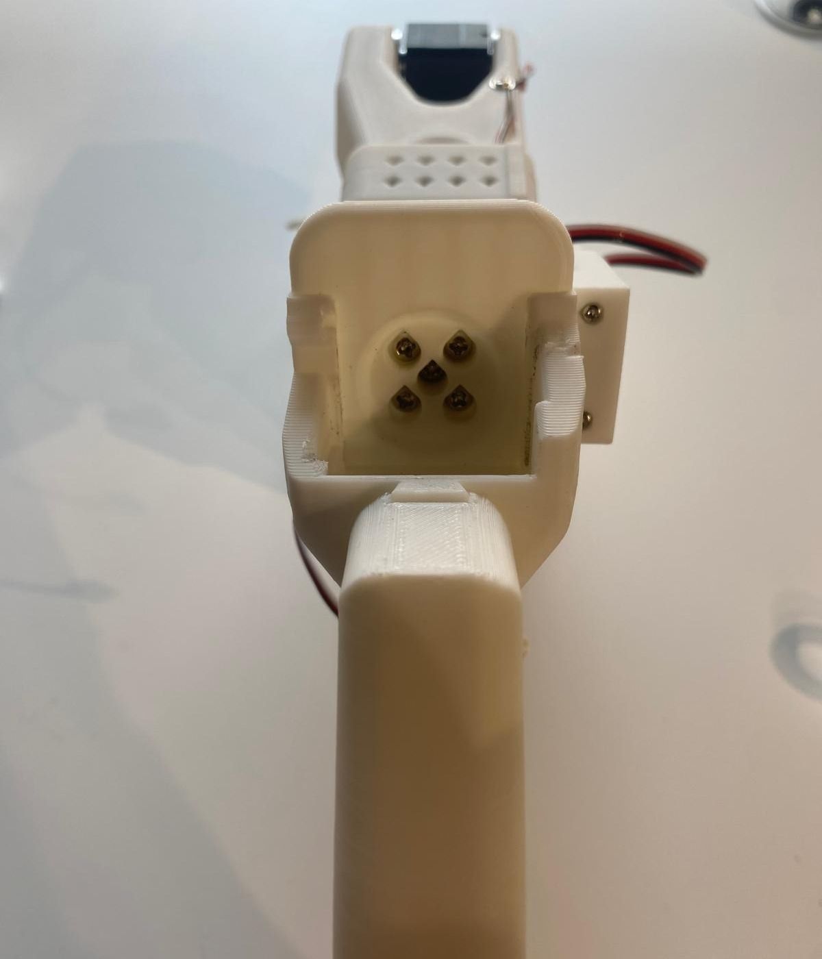

Step 23: Attach Wrist Horn
  • Install only one motor horn on the wrist motor and secure it with a horn screw.

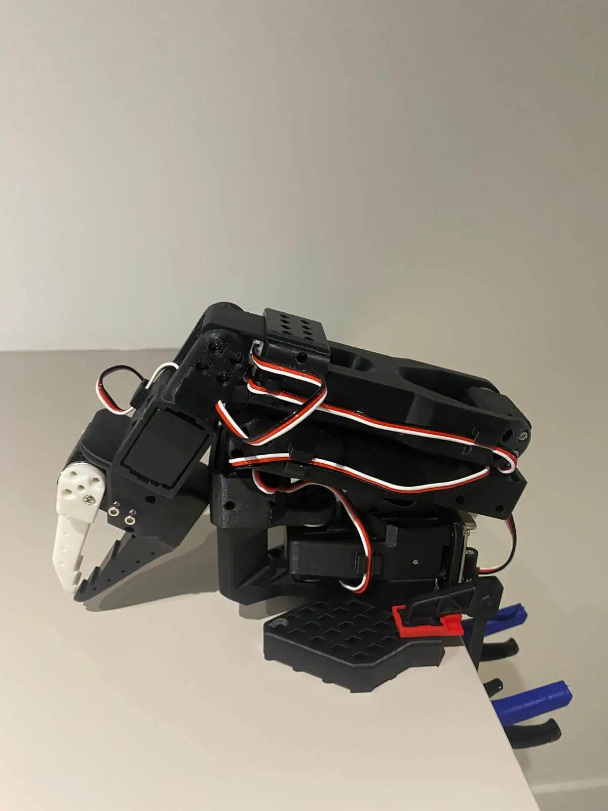

Follower Configuration

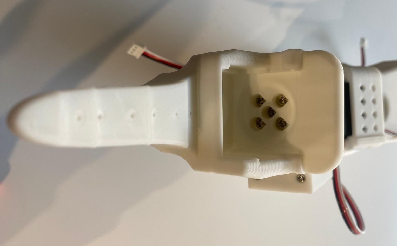

Step 24: Attach Gripper
  • Attach the gripper to motor 5.
Step 25: Install Gripper Motor
  • Insert the gripper motor, connect the motor wire from motor 5 to motor 6, and secure it with 3 screws on each side.
Step 26: Attach Gripper Horn & Claw
  • Attach the motor horns and again use a horn screw.
  • Install the gripper claw and secure it with 4 screws on both sides.

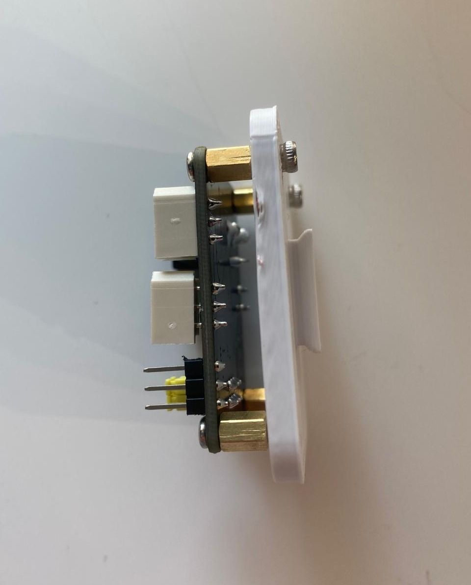

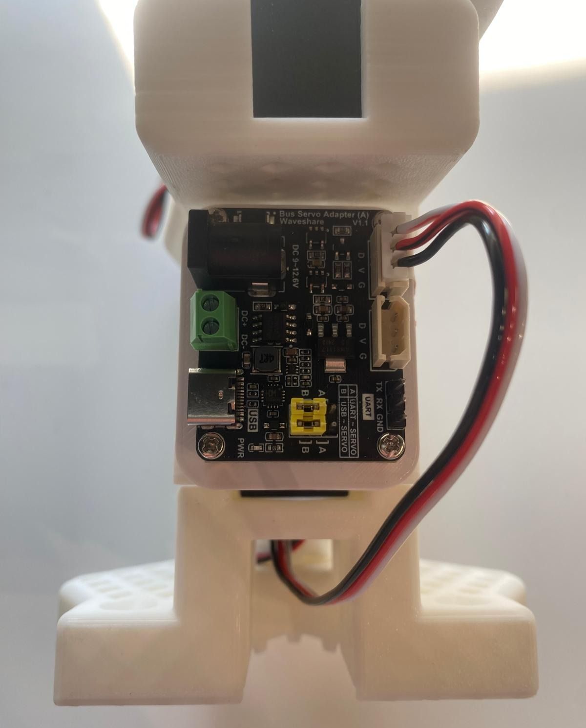

Step 27: Mount Controller
Assembly complete proceed to Leader arm assembly.

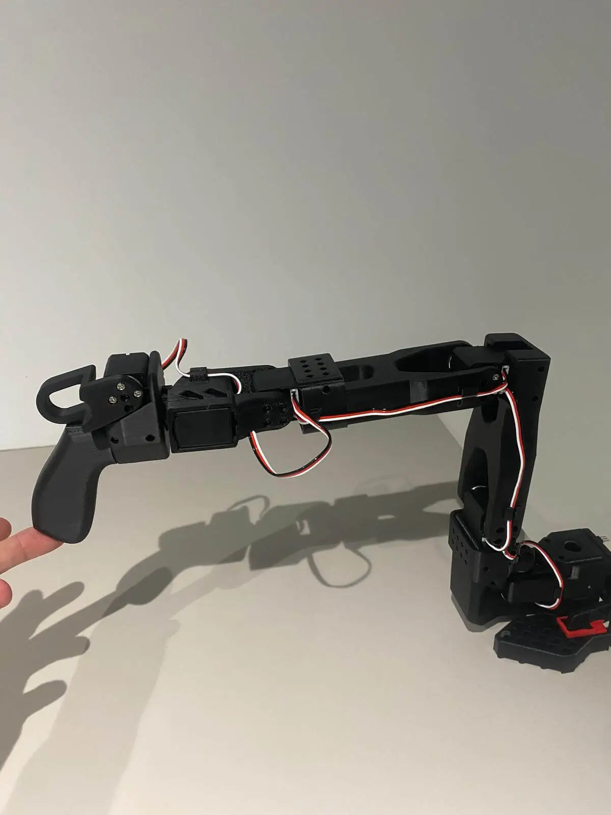

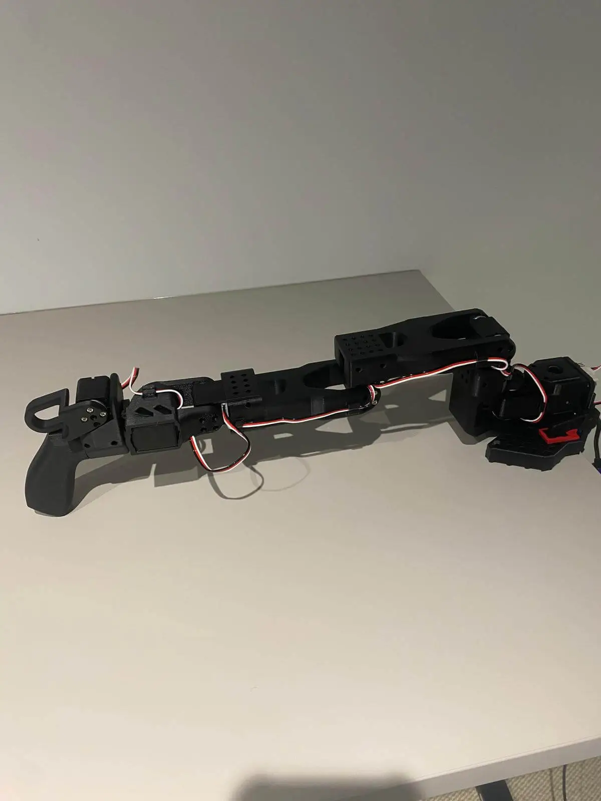

Leader Configuration
For the leader configuration, perform Steps 123. Make sure that you removed the motor gears from the motors.
Step 24: Attach Leader Holder
  • Mount the leader holder onto the wrist and secure it with a screw.

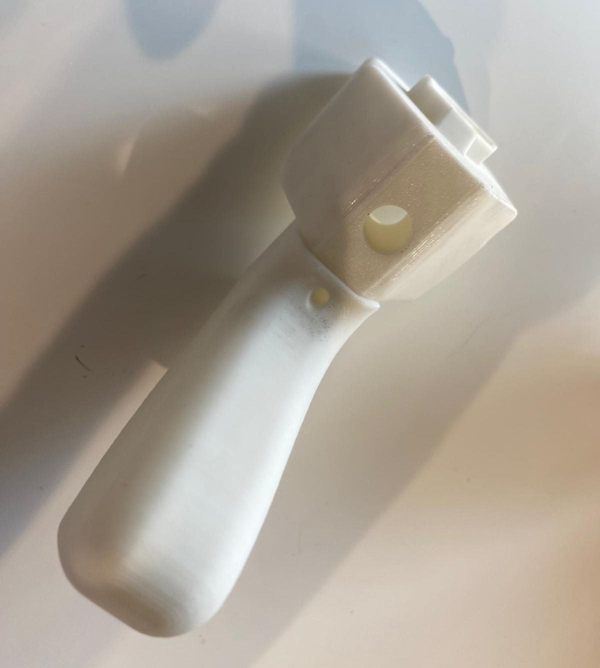

Step 25: Attach Handle
  • Attach the handle to motor 5 using 4 screws.
Step 26: Install Gripper Motor
  • Insert the gripper motor, secure it with 3 screws on each side, attach a motor horn using a horn screw, and connect the motor wire.
Step 27: Attach Trigger
  • Attach the follower trigger with 4 screws.
Step 28: Mount Controller
Assembly complete proceed to calibration.

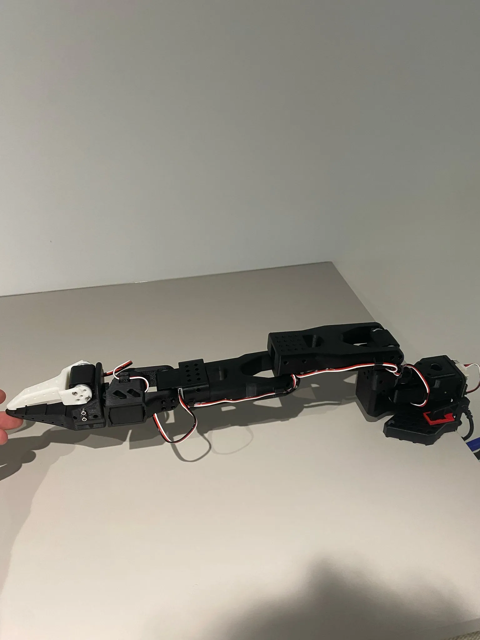

Manual calibration of follower arm
You will need to move the follower arm to these positions sequentially, note that the rotated position is on the right side of the robot and you have to open the gripper fully.
1. Middle position 2. Zero position 3. Rotated position 4. Rest position
