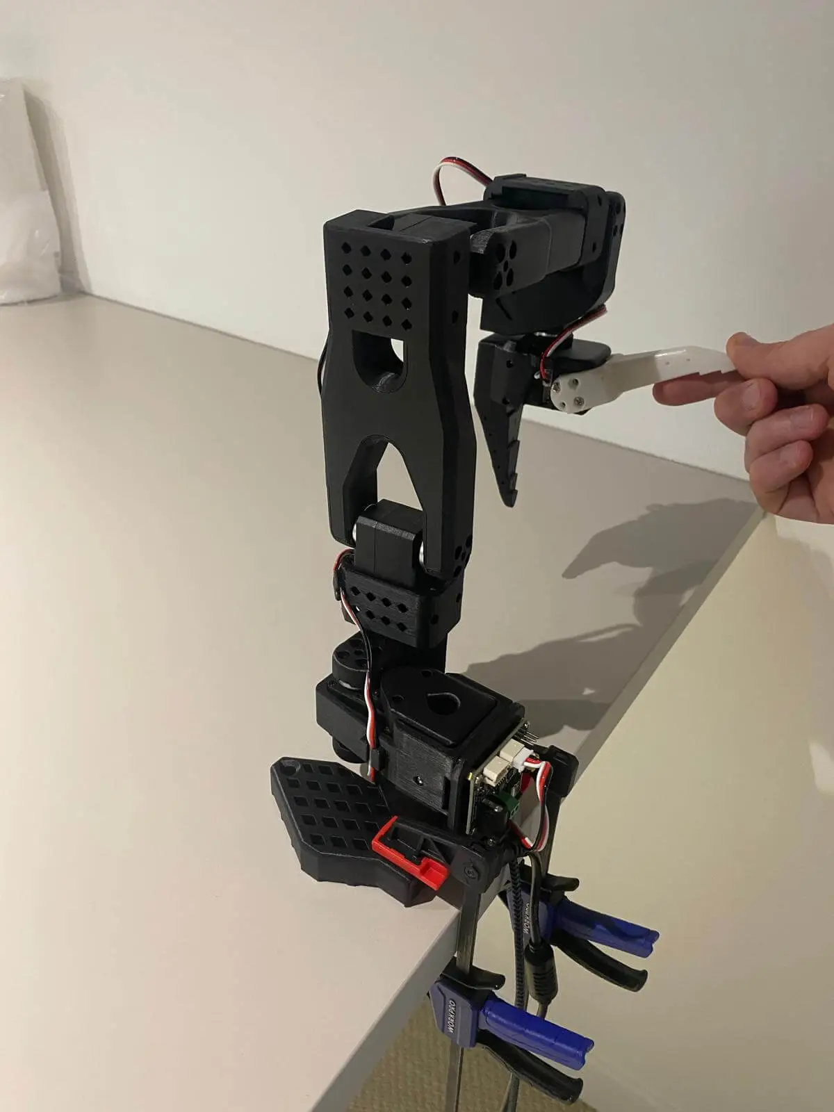

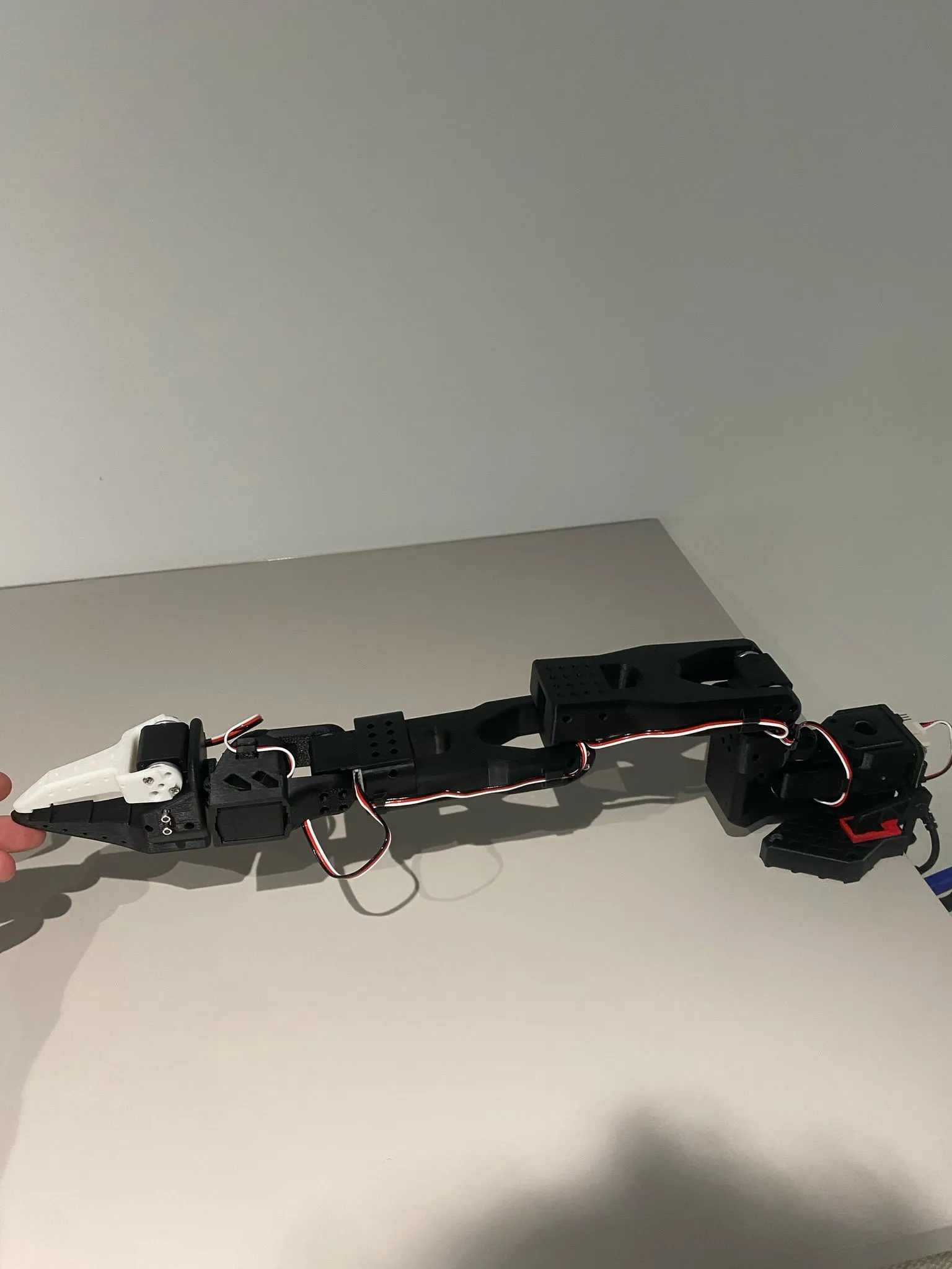

You will need to move the follower arm to these positions sequentially, note that the rotated position is on the right side of the robot and you have to open the gripper fully.
1. Middle position 2. Zero position 3. Rotated position 4. Rest position
SO-101 leader arm middle position SO-101 leader arm zero position SO-101 leader arm rotated position SO-101 leader arm rest position

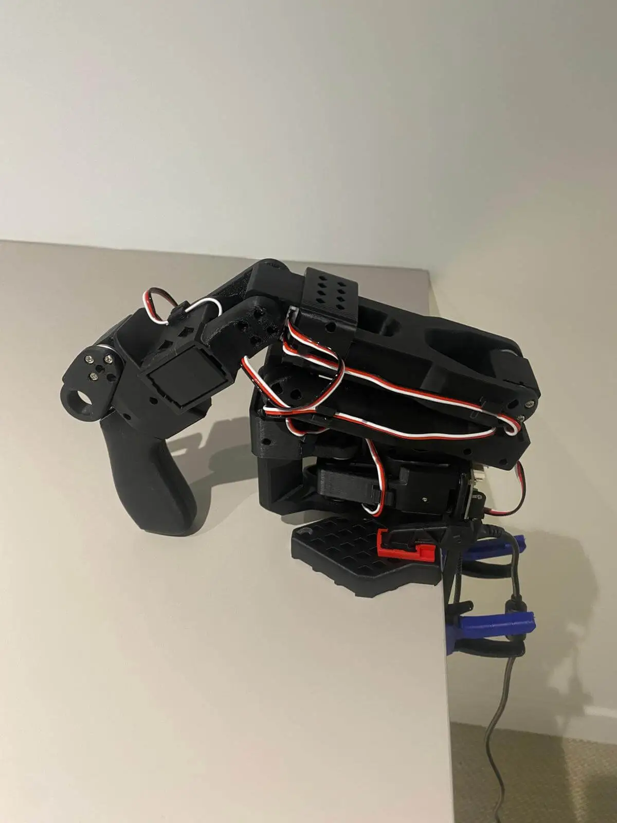

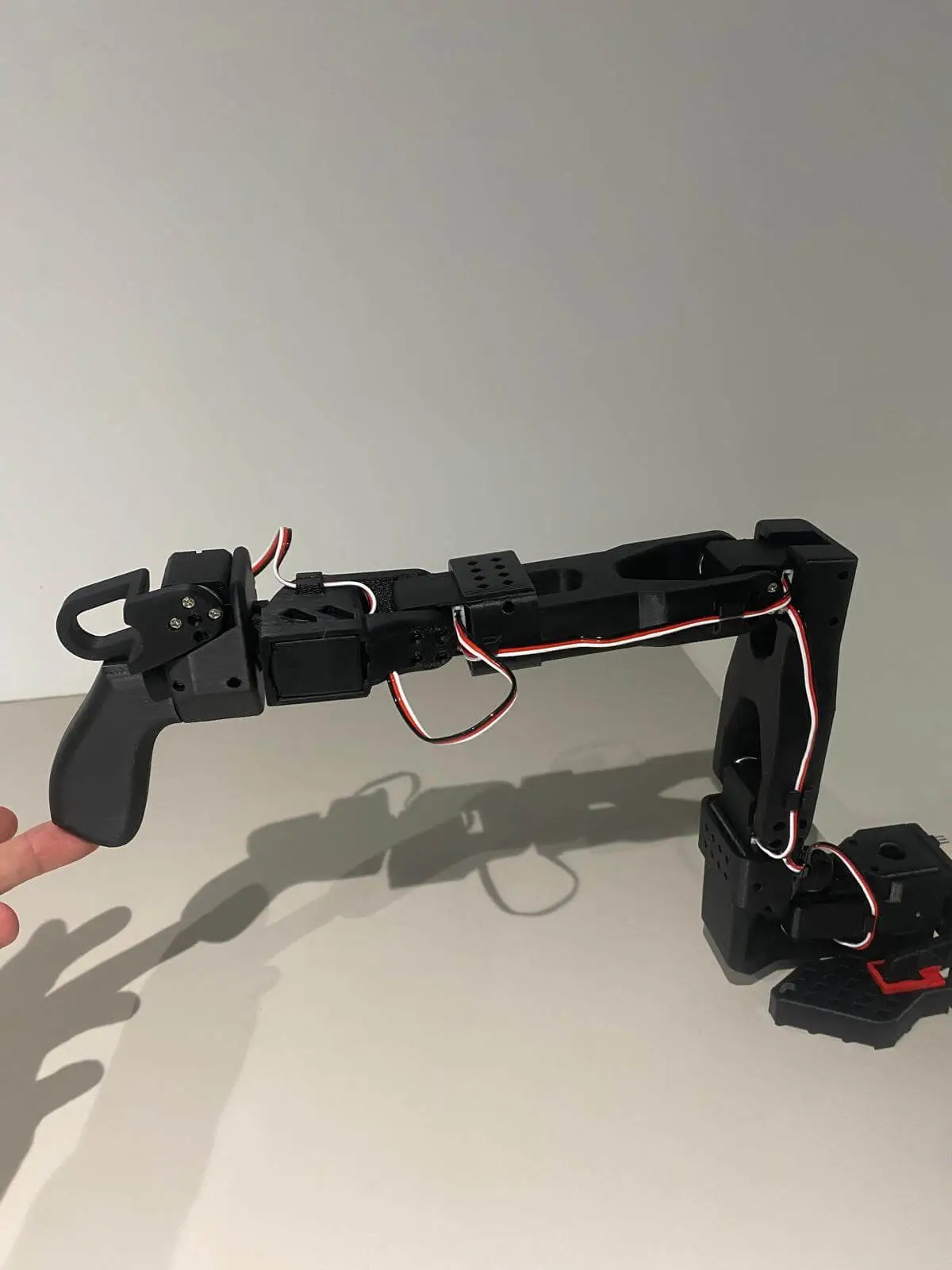

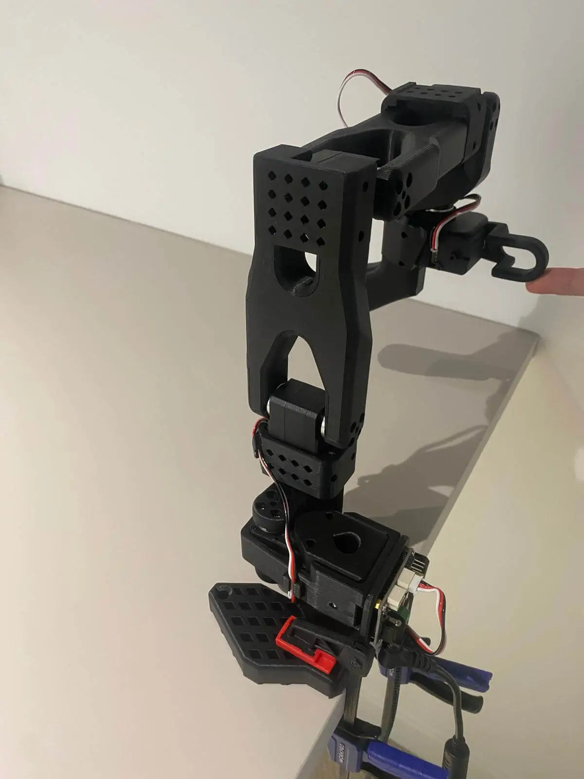

You will also need to move the leader arm to these positions sequentially:
