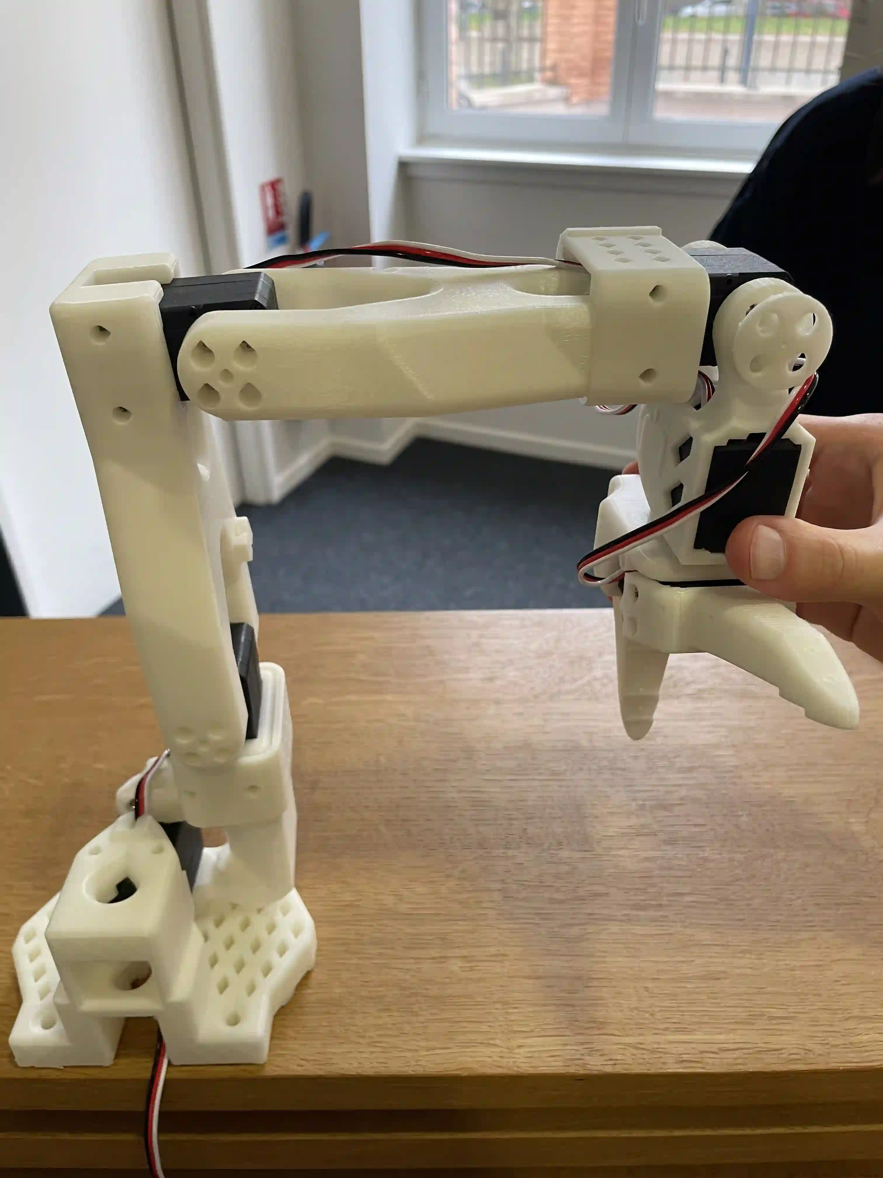

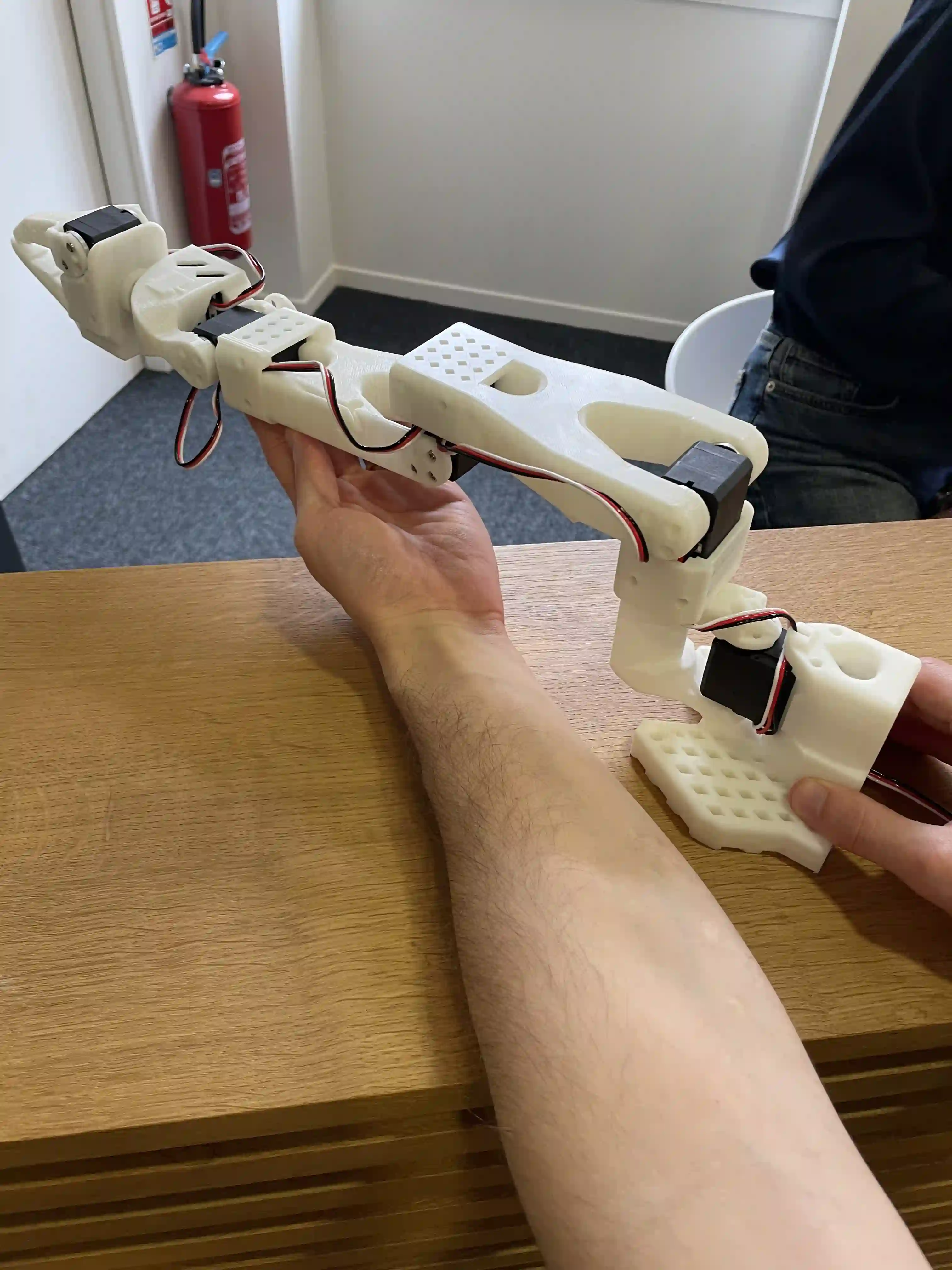

Calibrate
    --robot-path lerobot/configs/robot/so100.yaml \
