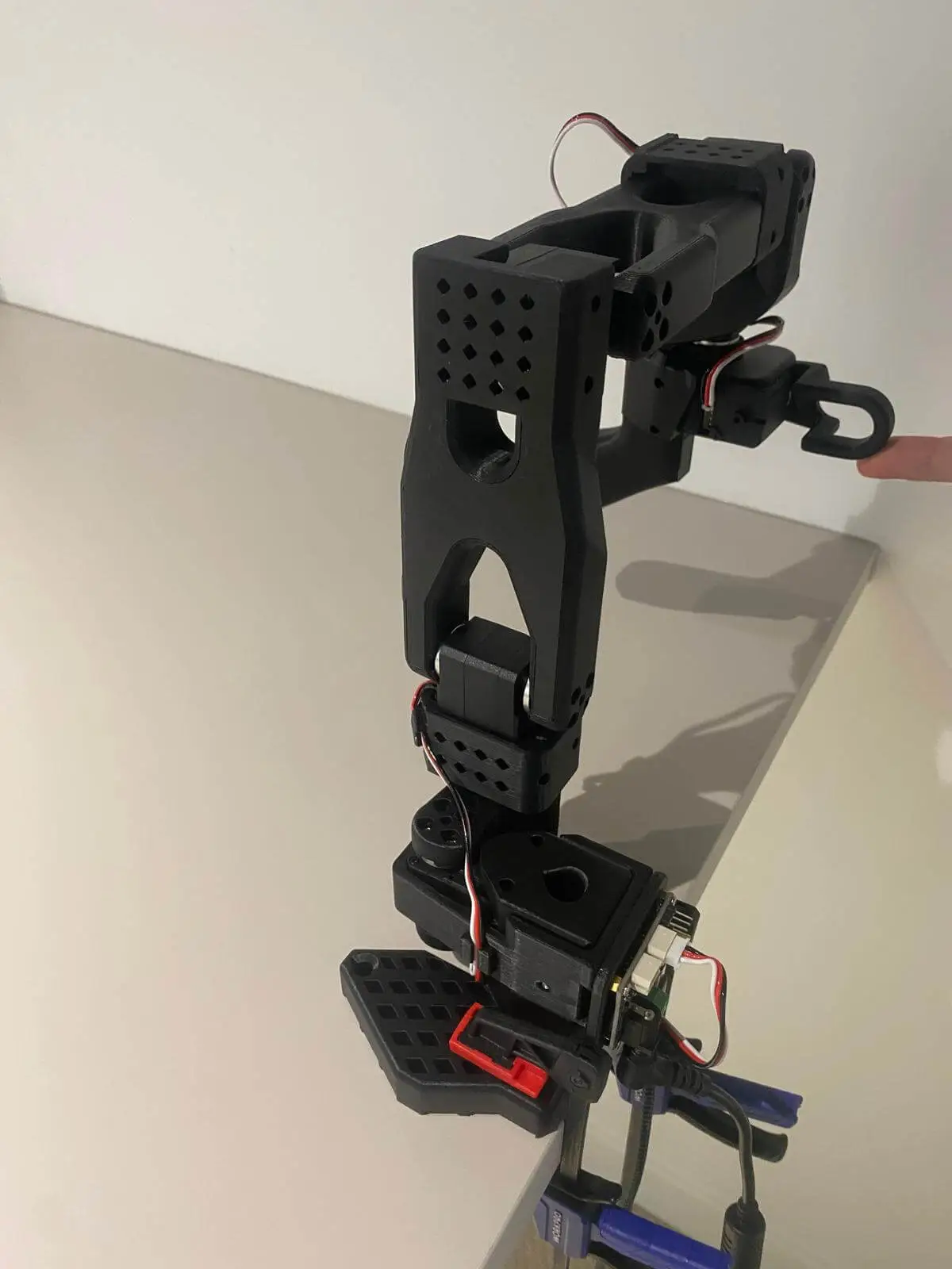

Step-by-Step Assembly Instructions
The follower arm uses 6x STS3215 motors with 1/345 gearing. The leader however uses three differently geared motors to make sure it can both sustain its own weight and it can be moved without requiring much force. Which motor is needed for which joint is shown in table below.
Leader-Arm Axis Motor Gear Ratio
Base / Shoulder Yaw 1 1 / 191
Shoulder Pitch 2 1 / 345
Elbow 3 1 / 191
Wrist Roll 4 1 / 147
Wrist Pitch 5 1 / 147
Gripper 6 1 / 147
Clean Parts
Remove all support material from the 3D-printed parts.
Joint 1
  • Fasten the motor with 4 M2x6mm screws (smallest screws). Two from the top and two from bottom.
  • Slide over the first motor holder and fasten it using two M2x6mm screws (one on each side).
  • Install both motor horns, securing the top horn with a M3x6mm screw.
  • Attach the shoulder part.
  • Tighten the shoulder part with 4 M3x6mm screws on top and 4 M3x6mm screws on the bottom
Joint 2
  • Slide the second motor in from the top.
  • Fasten the second motor with 4 M2x6mm screws.
  • Attach both motor horns to motor 2, again use the M3x6mm horn screw.
  • Attach the upper arm with 4 M3x6mm screws on each side.
Joint 3
  • Insert motor 3 and fasten using 4 M2x6mm screws
  • Attach both motor horns to motor 3 and secure one again with a M3x6mm horn screw.
  • Connect the forearm to motor 3 using 4 M3x6mm screws on each side.
Joint 4
  • Slide over motor holder 4.
  • Slide in motor 4.
  • Fasten motor 4 with 4 M2x6mm screws and attach its motor horns, use a M3x6mm horn screw.
Joint 5
  • Insert motor 5 into the wrist holder and secure it with 2 M2x6mm front screws.
  • Install only one motor horn on the wrist motor and secure it with a M3x6mm horn screw.
  • Secure the wrist to motor 4 using 4 M3x6mm screws on both sides.
Gripper / Handle
Follower:
  • Attach the gripper to motor 5, attach it to the motor horn on the wrist using 4 M3x6mm screws.
  • Insert the gripper motor and secure it with 2 M2x6mm screws on each side.
  • Attach the motor horns and again use a M3x6mm horn screw.
  • Install the gripper claw and secure it with 4 M3x6mm screws on both sides.
Leader:
  • Mount the leader holder onto the wrist and secure it with 4 M3x6mm screws.
  • Attach the handle to motor 5 using 1 M2x6mm screw.
  • Insert the gripper motor, secure it with 2 M2x6mm screws on each side, attach a motor horn using a M3x6mm horn screw.
  • Attach the follower trigger with 4 M3x6mm screws.
