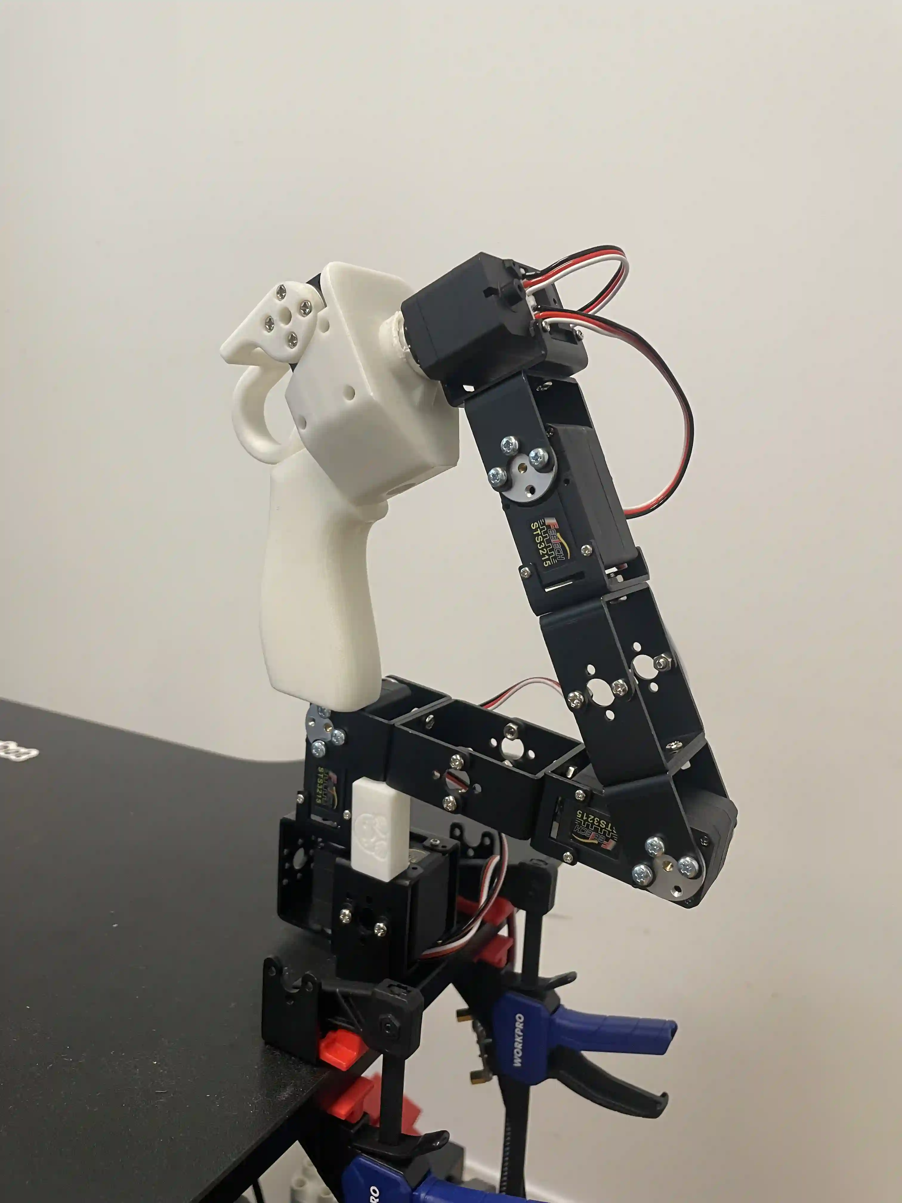

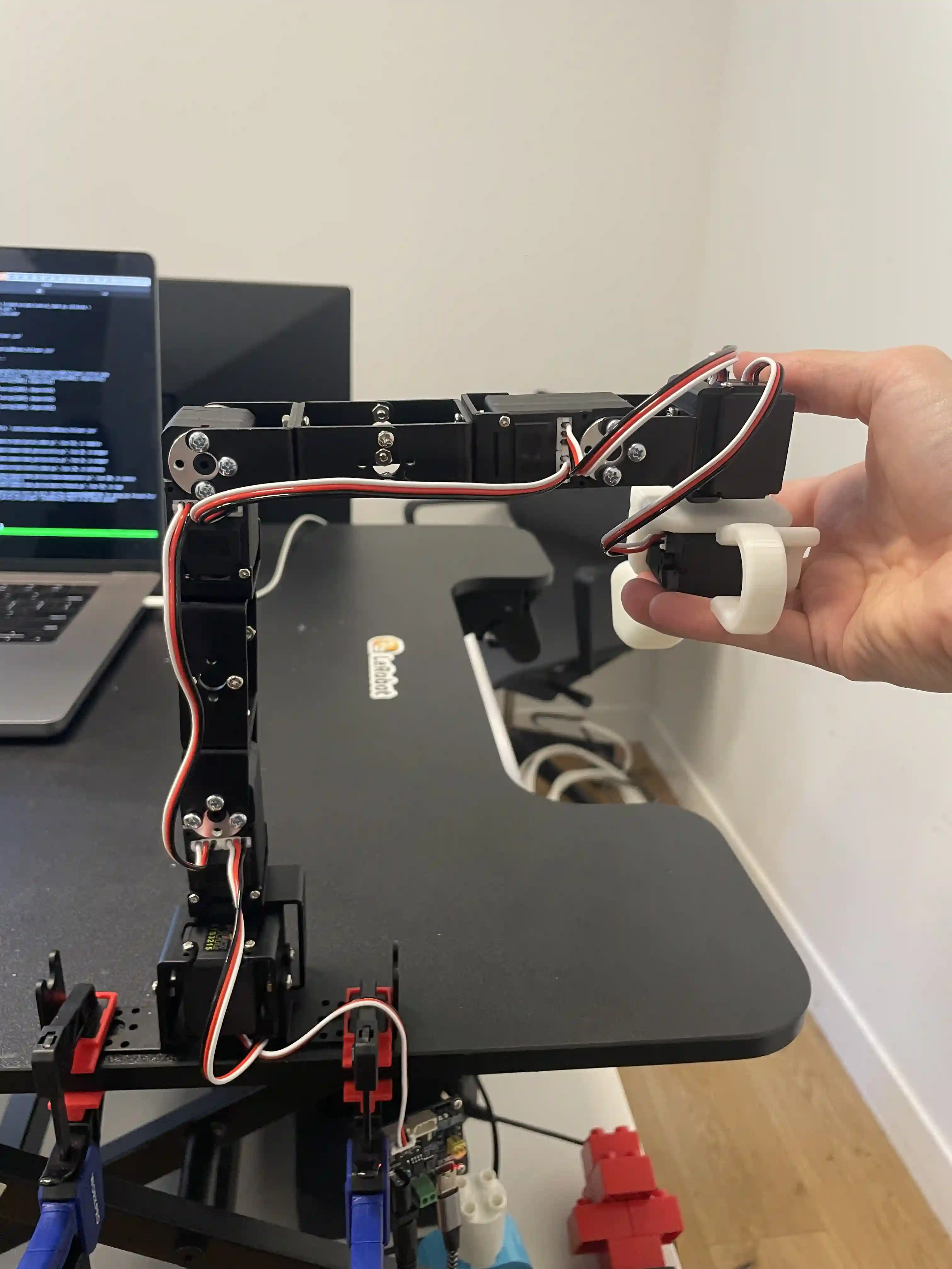

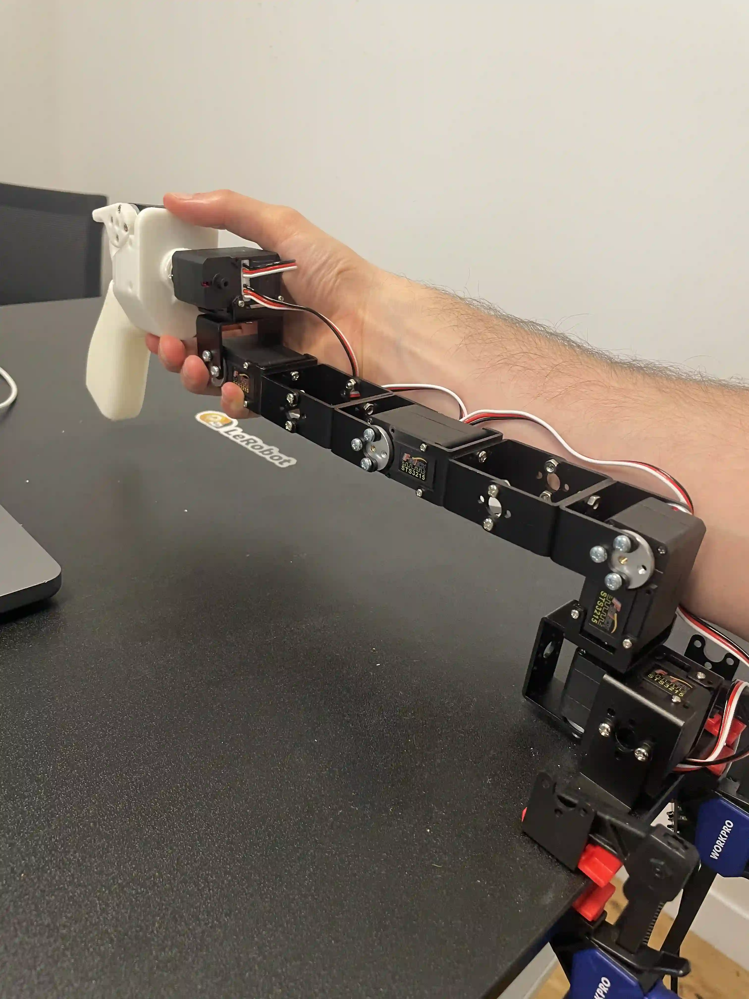

Assemble the arms
Follow step 4 of the assembly video. The first arm should take a bit more than 1 hour to assemble, but once you get used to it, you can do it under 1 hour for the second arm.
