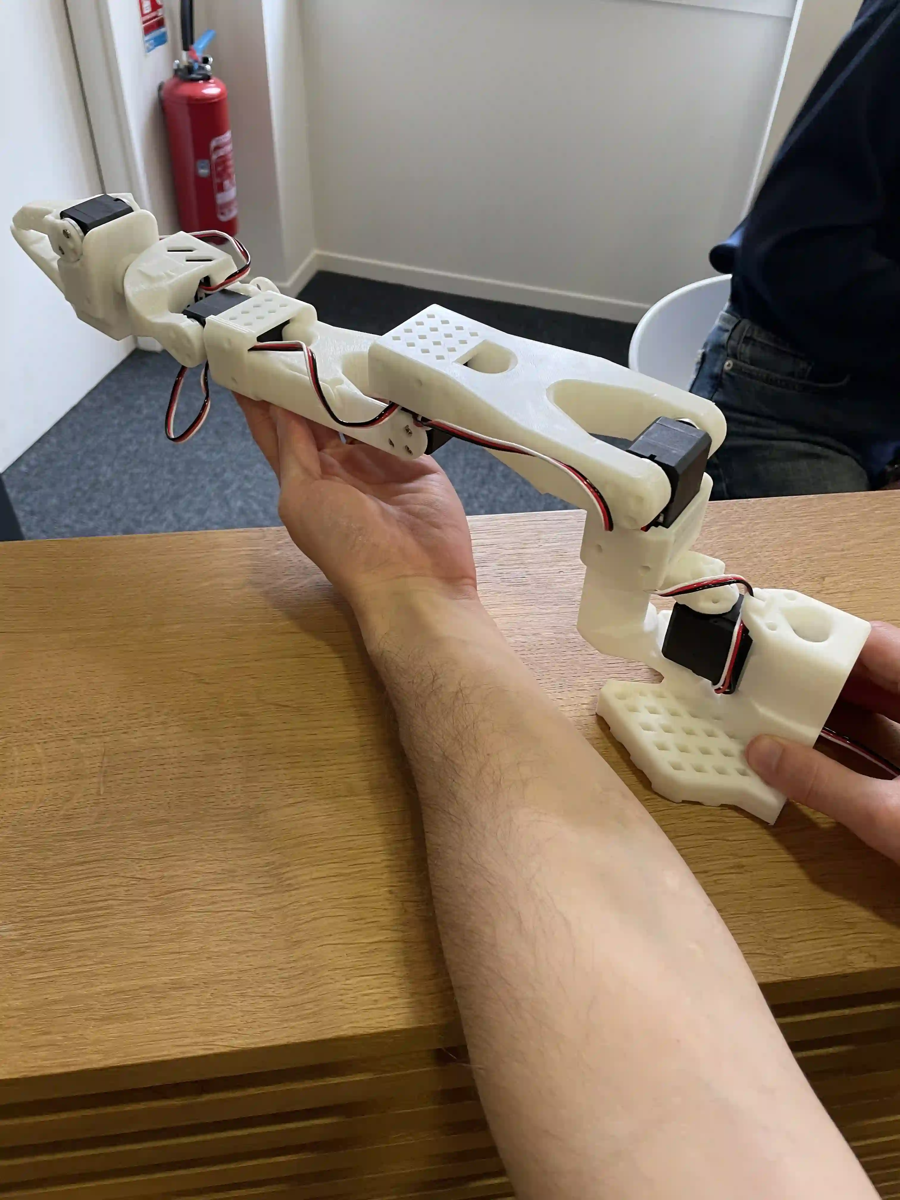

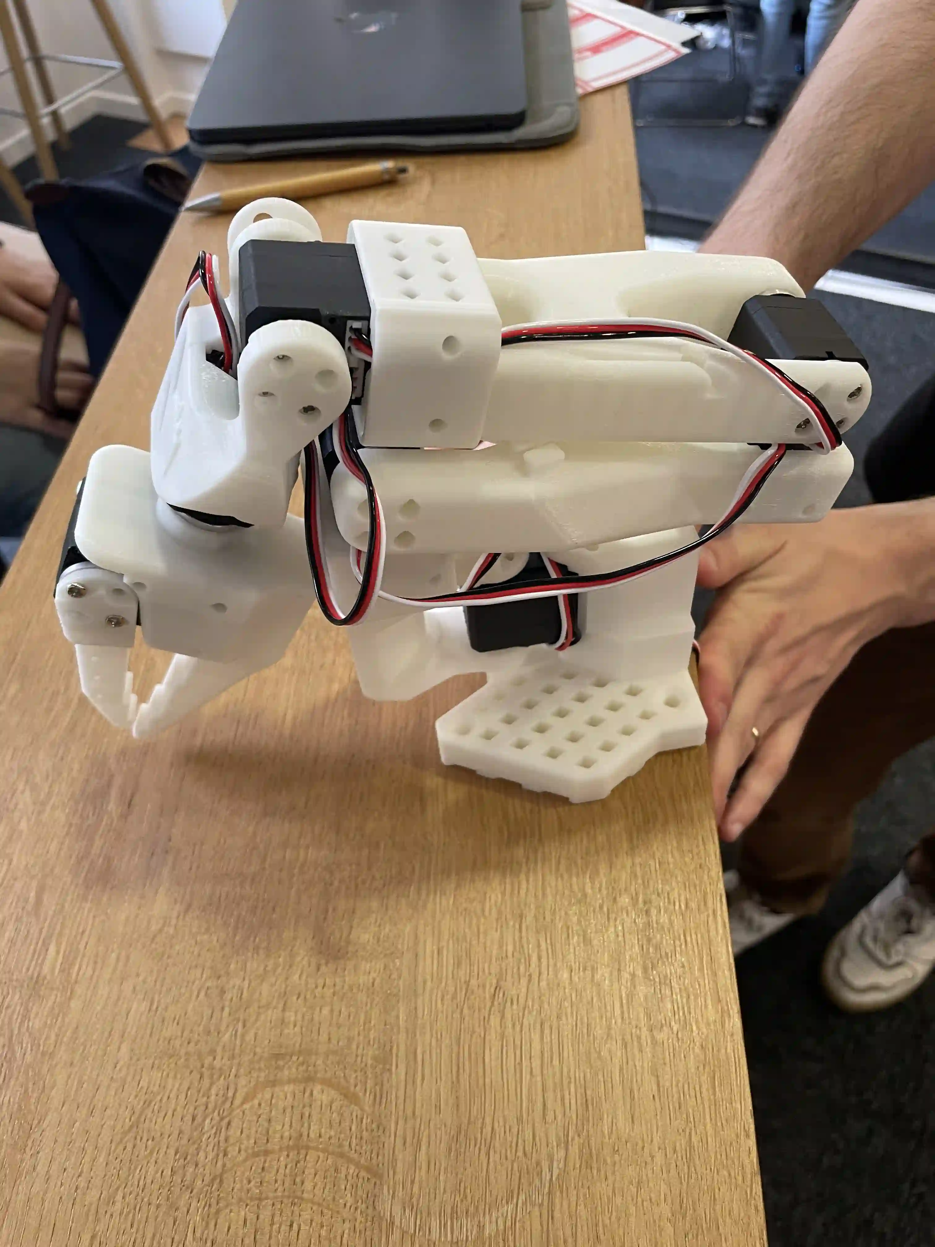

E. Calibrate
a. Manual calibration of follower arm
Important
  --robot.type=so100 \
  --robot.cameras='{}' \
  --control.type=calibrate \
