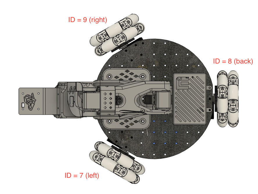

Motor ID's for mobile robot
Assemble arms
Assemble arms instruction
