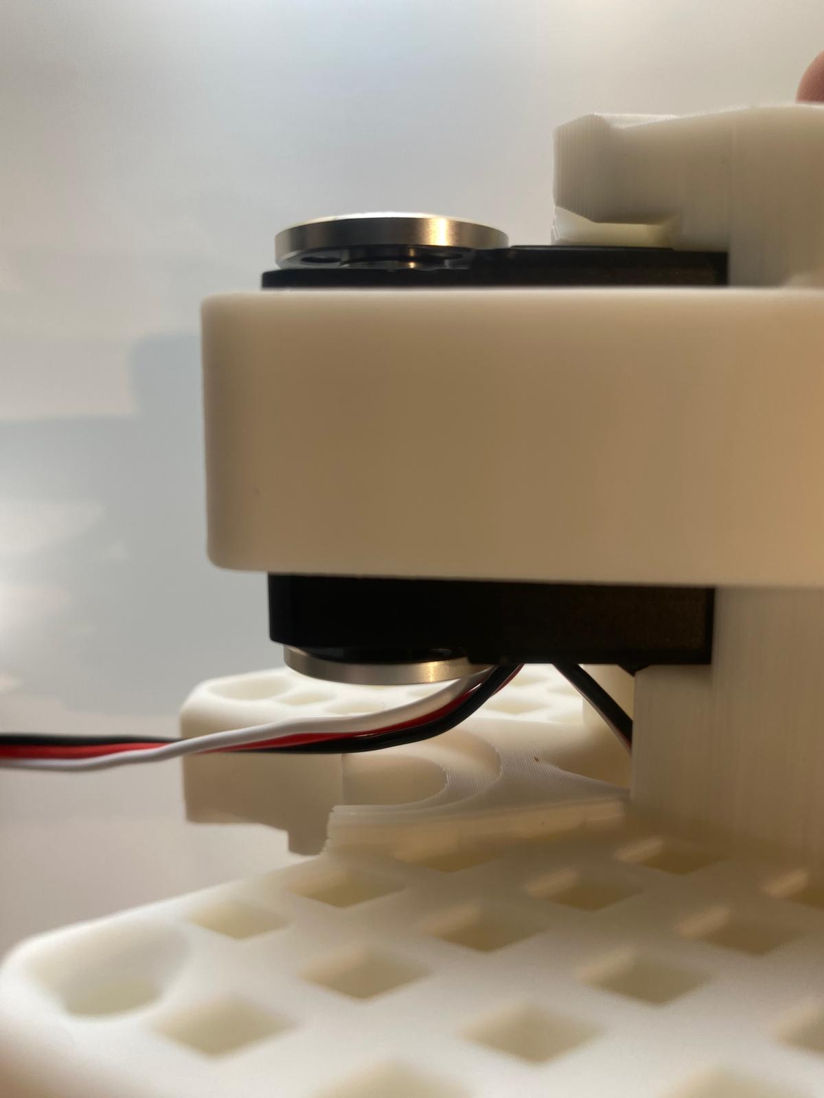

Step 3: Install in Base
Step 4: Secure Motor
  • Fasten the motor with 4 screws. Two from the bottom and two from top.

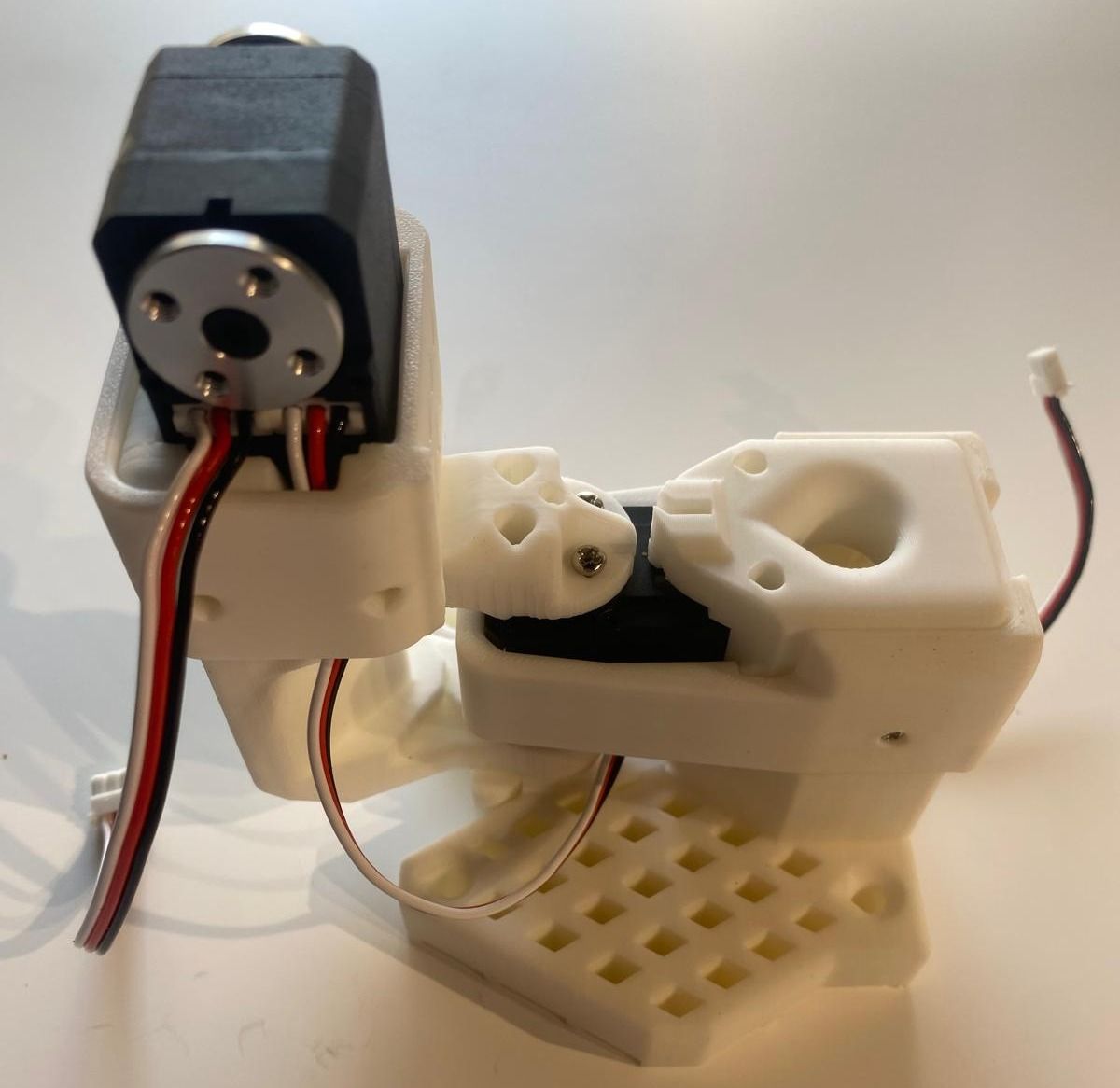

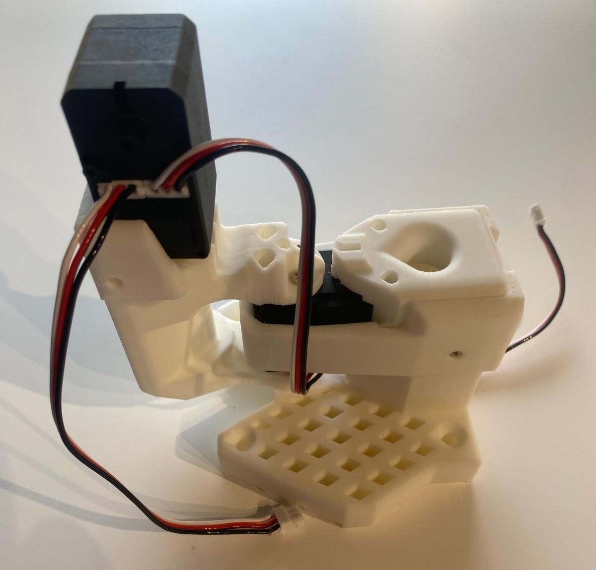

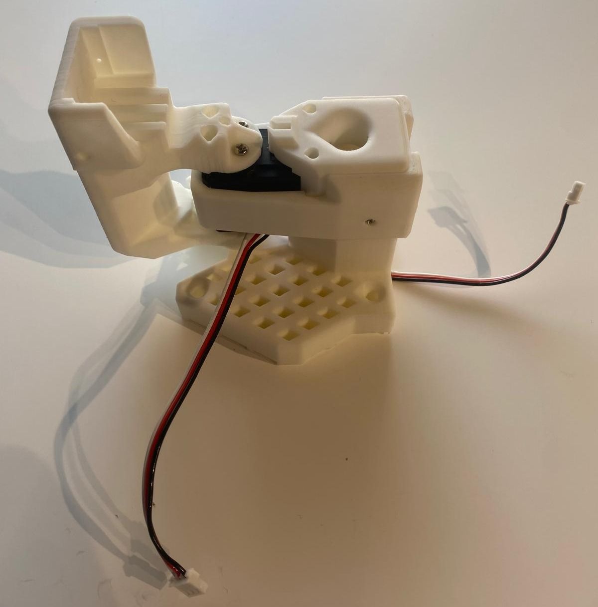

  • Slide the second motor in from the top and link the wire from motor 1 to motor 2.
Step 10: Attach Shoulder Holder
  • Ensure the wire from motor 1 to motor 2 goes behind the holder while the other wire is routed upward (see photo).
  • This part can be tight to assemble, you can use a workbench like the image or a similar setup to push the part around the motor.

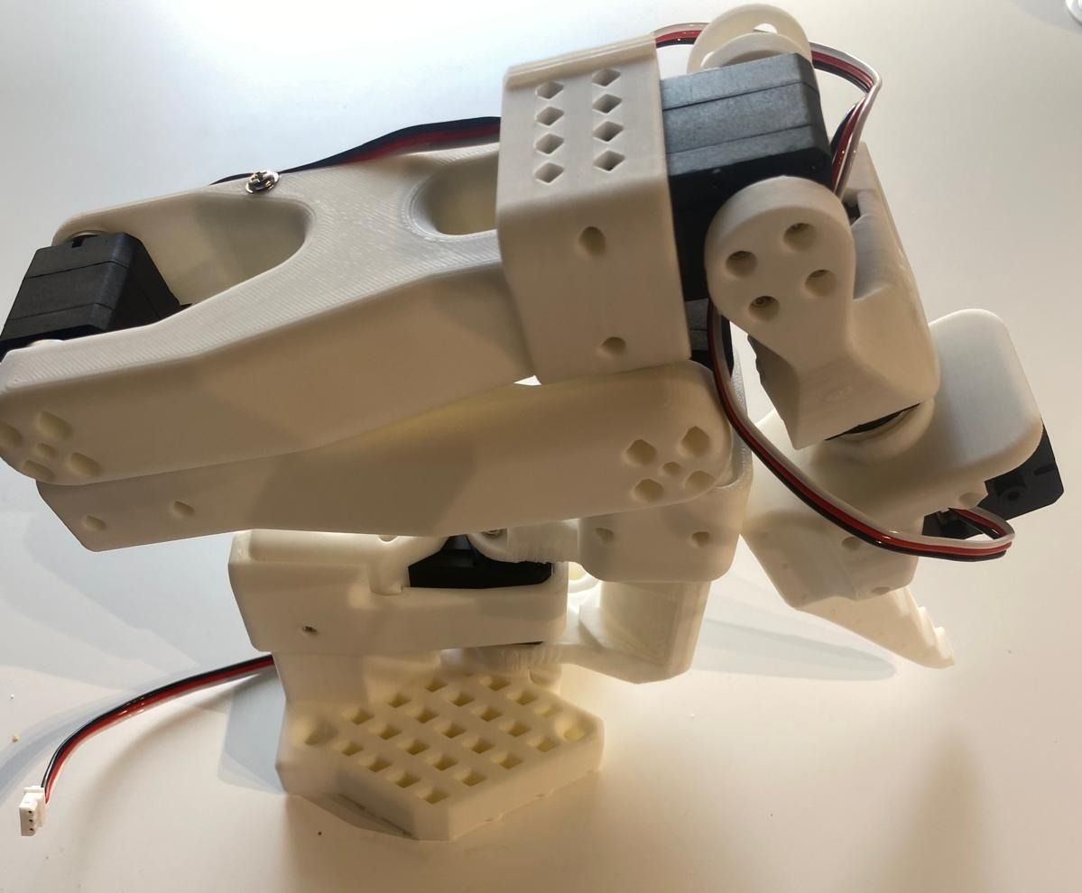

Step 14: Attach Upper Arm
  • Attach the upper arm with 4 screws on each side.

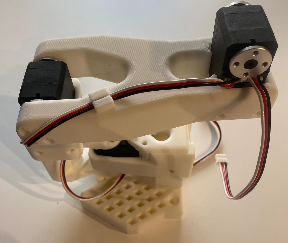

  • Route the motor cable from motor 2 through the cable holder to motor 3, then secure motor 3 with 4 screws.
Step 16: Attach Motor Horn
  • Attach both motor horns to motor 3 and secure one again with a horn screw.

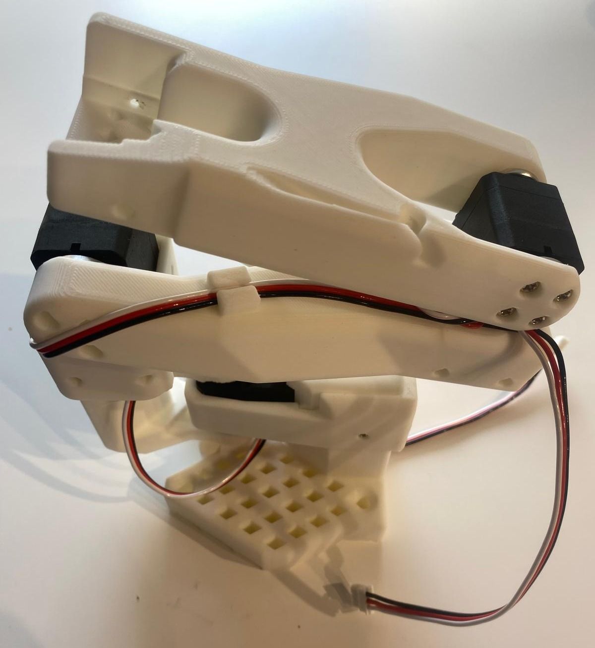

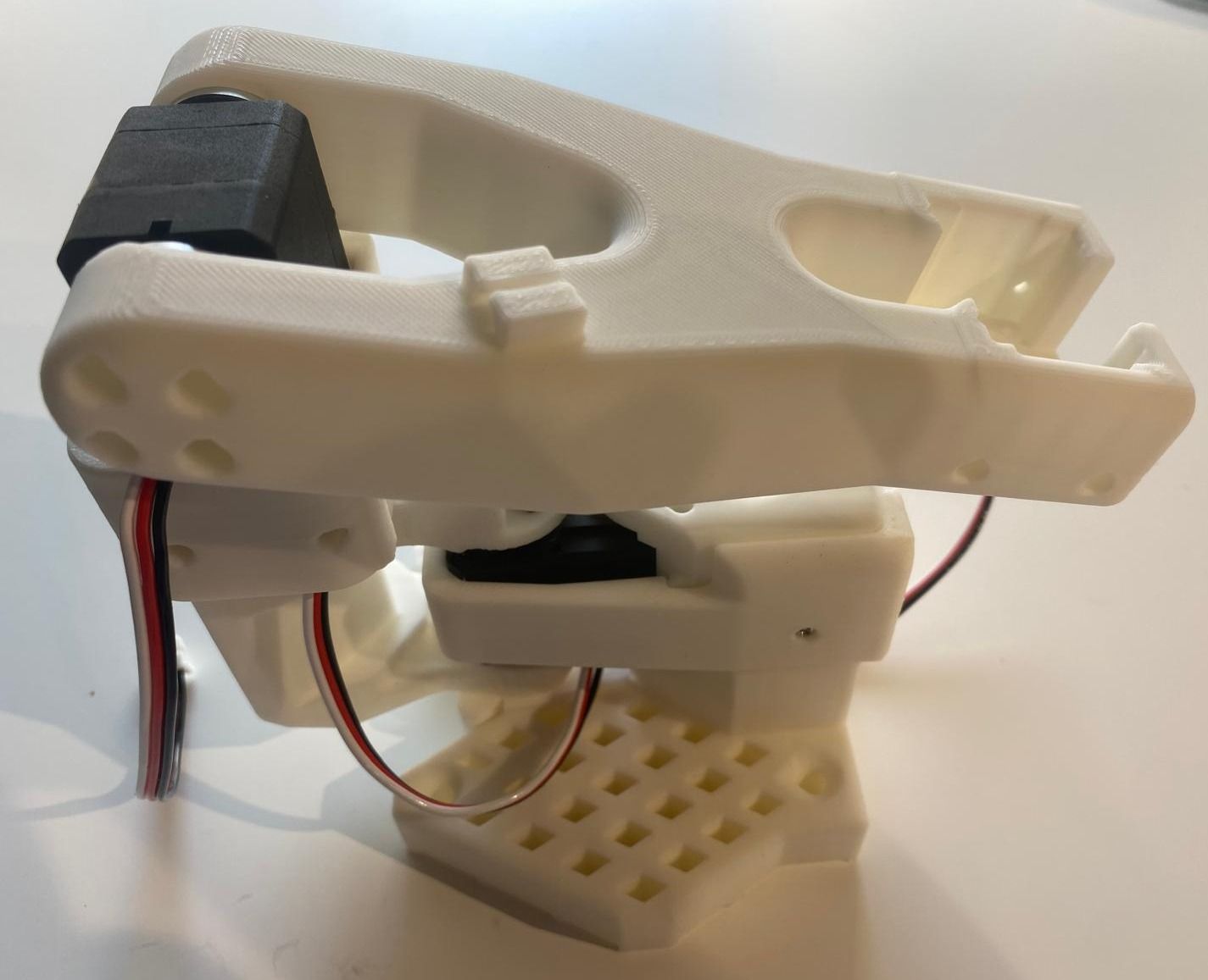

Step 17: Attach Forearm
  • Connect the forearm to motor 3 using 4 screws on each side.

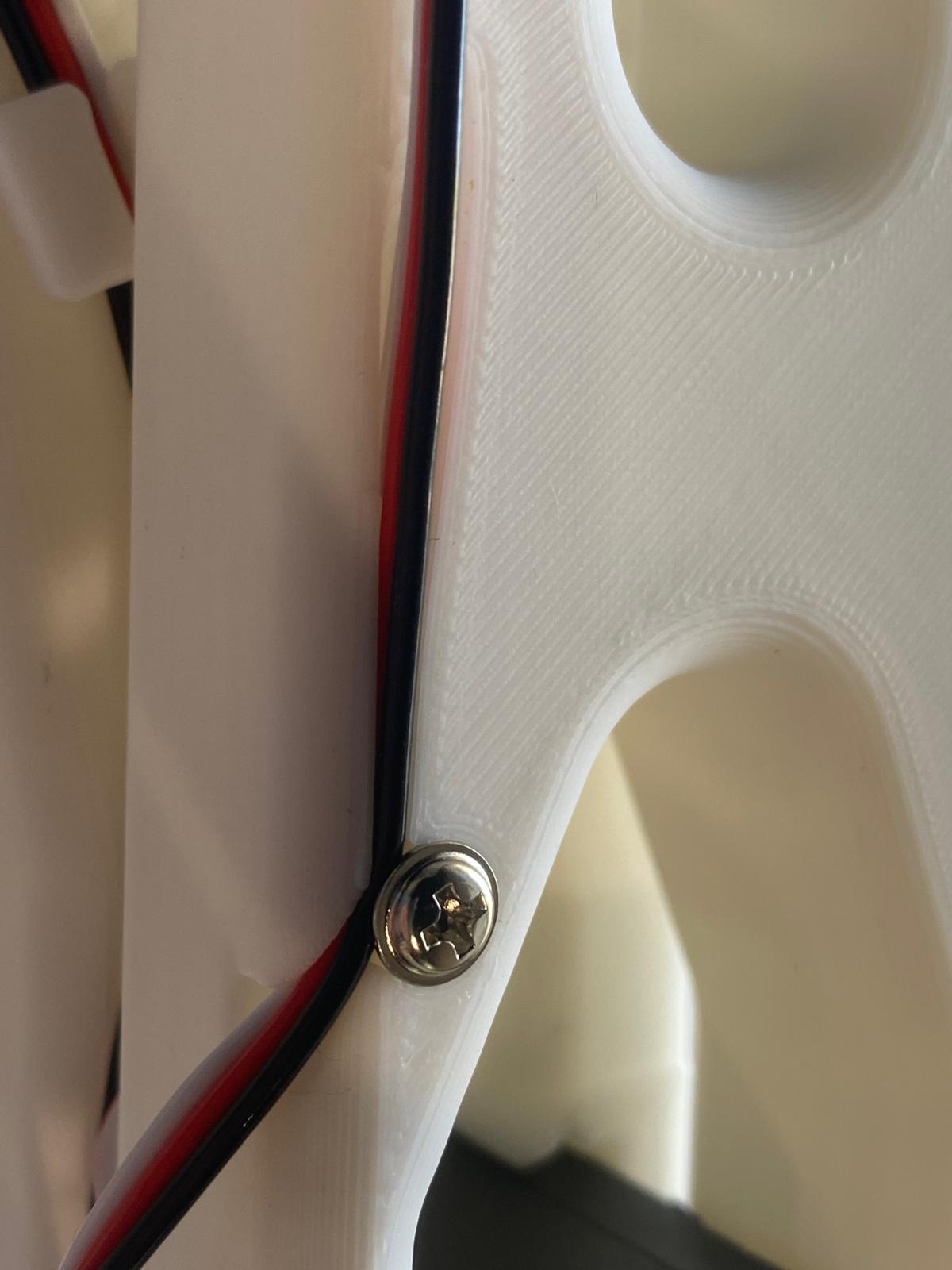

  • Slide in motor 4, attach the cable from motor 3, and secure the cable in its holder with a screw.

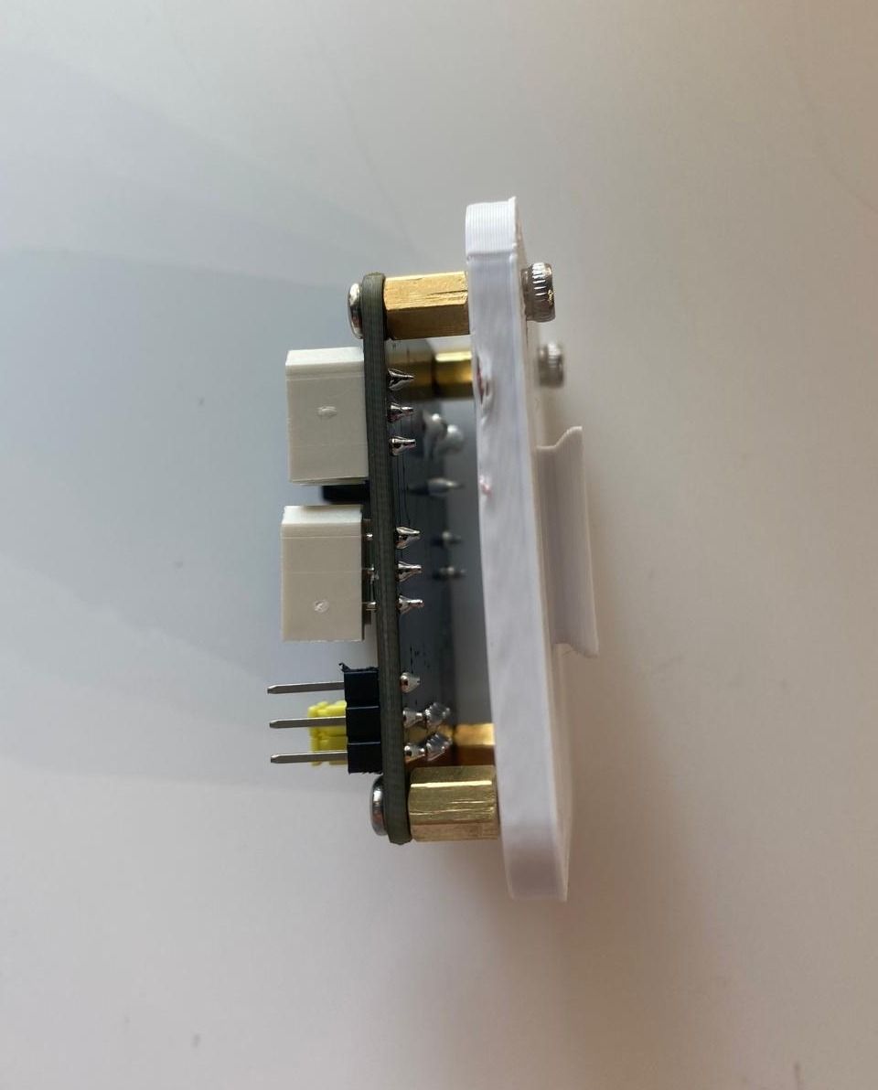

Step 27: Mount Controller
Assembly complete proceed to Leader arm assembly.

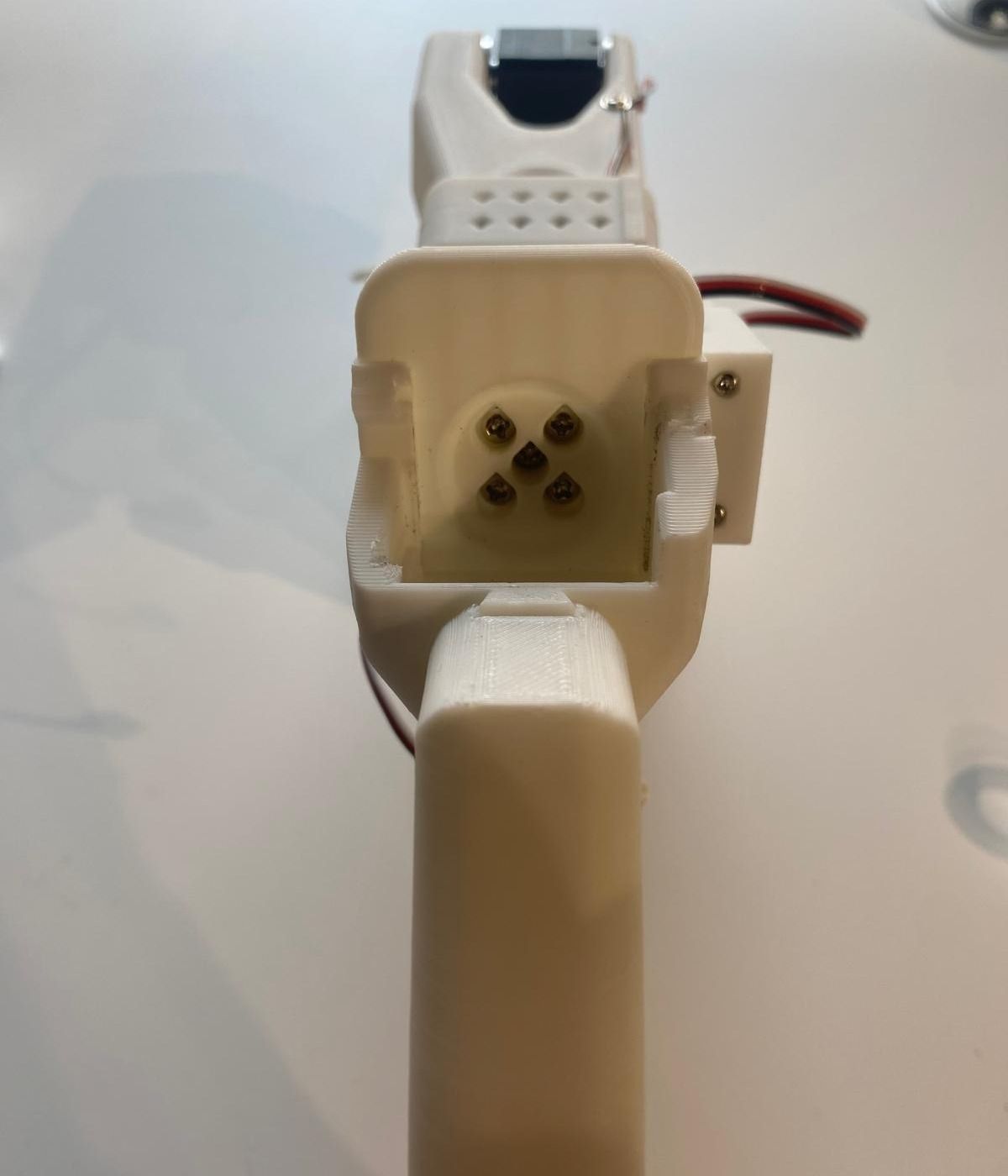

Step 24: Attach Leader Holder
  • Mount the leader holder onto the wrist and secure it with a screw.
Step 25: Attach Handle
  • Attach the handle to motor 5 using 4 screws.

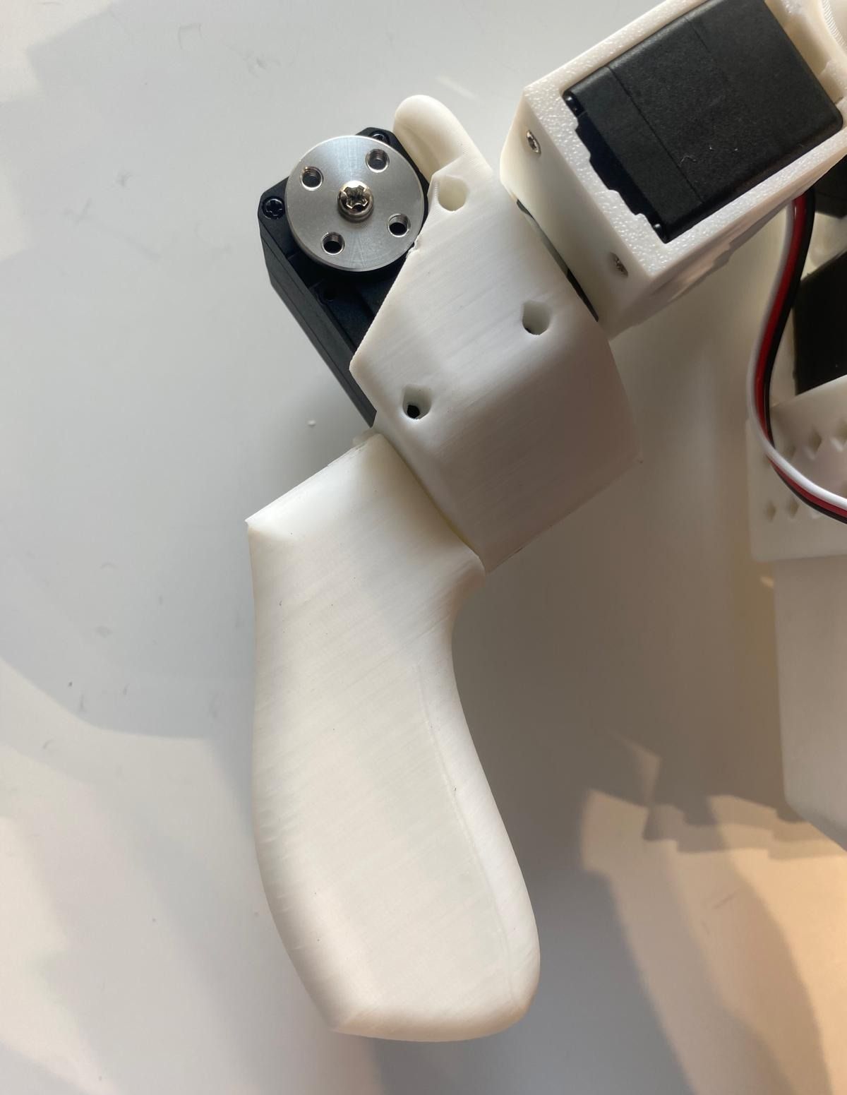

Step 26: Install Gripper Motor
  • Insert the gripper motor, secure it with 3 screws on each side, attach a motor horn using a horn screw, and connect the motor wire.

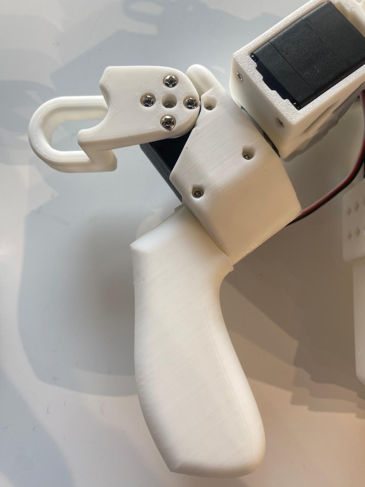

Step 27: Attach Trigger
  • Attach the follower trigger with 4 screws.

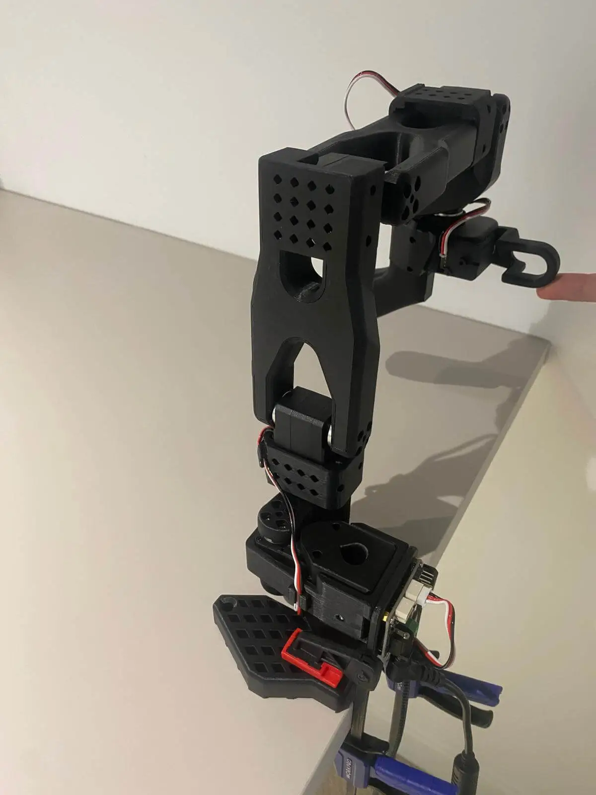

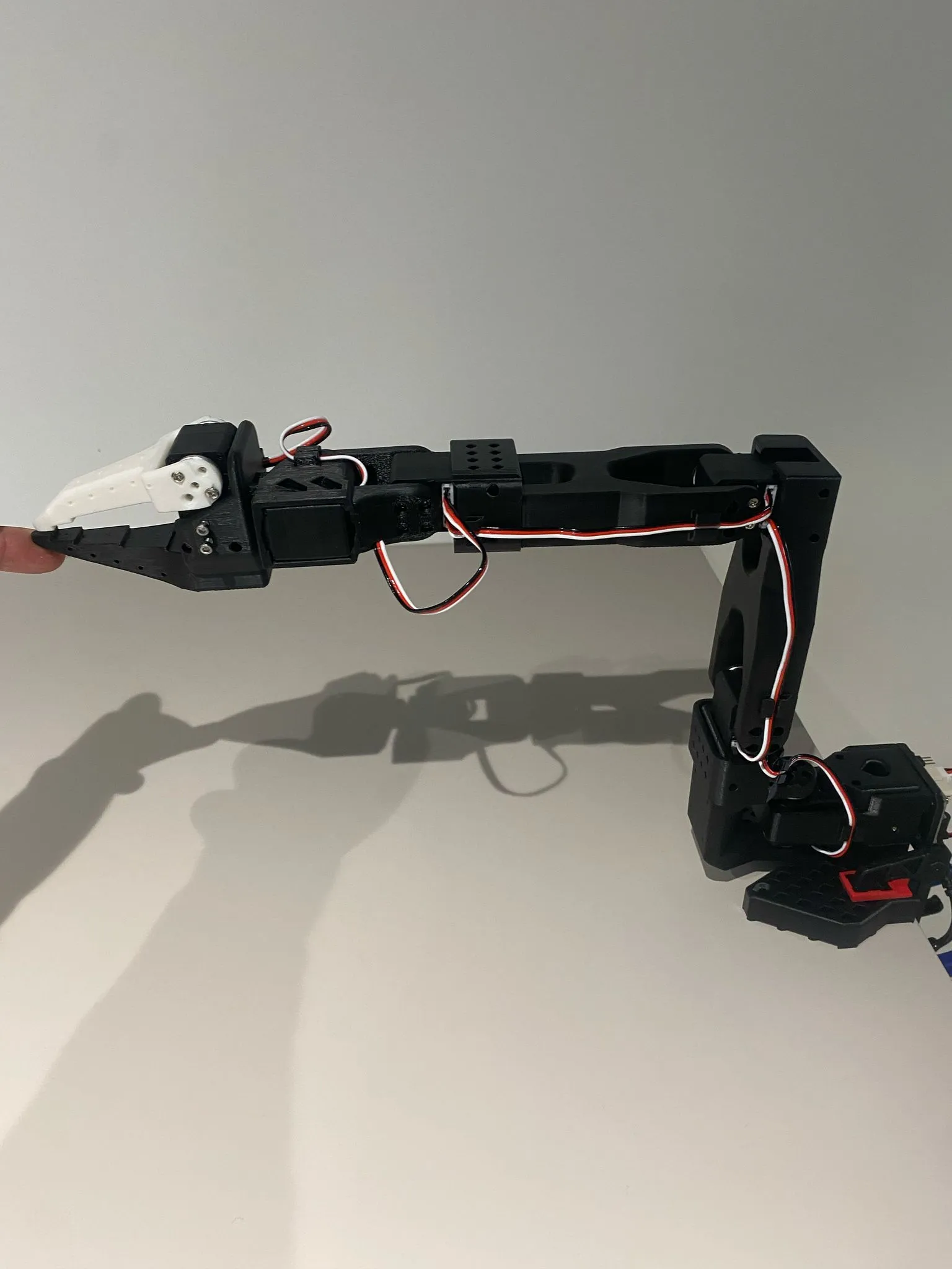

You will need to move the follower arm to these positions sequentially, note that the rotated position is on the right side of the robot and you have to open the gripper fully.
1. Middle position 2. Zero position 3. Rotated position 4. Rest position
SO-101 leader arm middle position SO-101 leader arm zero position SO-101 leader arm rotated position SO-101 leader arm rest position
