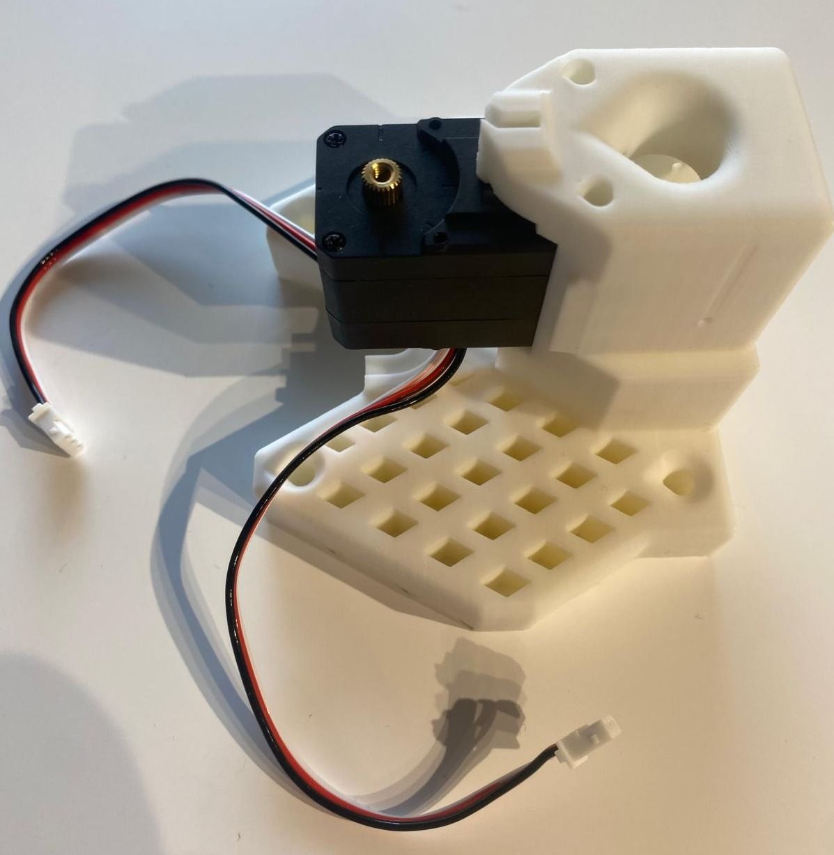

  • Insert two wires into the first motor.
Step 3: Install in Base
Step 4: Secure Motor
  • Fasten the motor with 4 screws. Two from the bottom and two from top.
Step 5: Attach Motor Holder
  • Slide over the first motor holder and fasten it using two screws (one on each side).

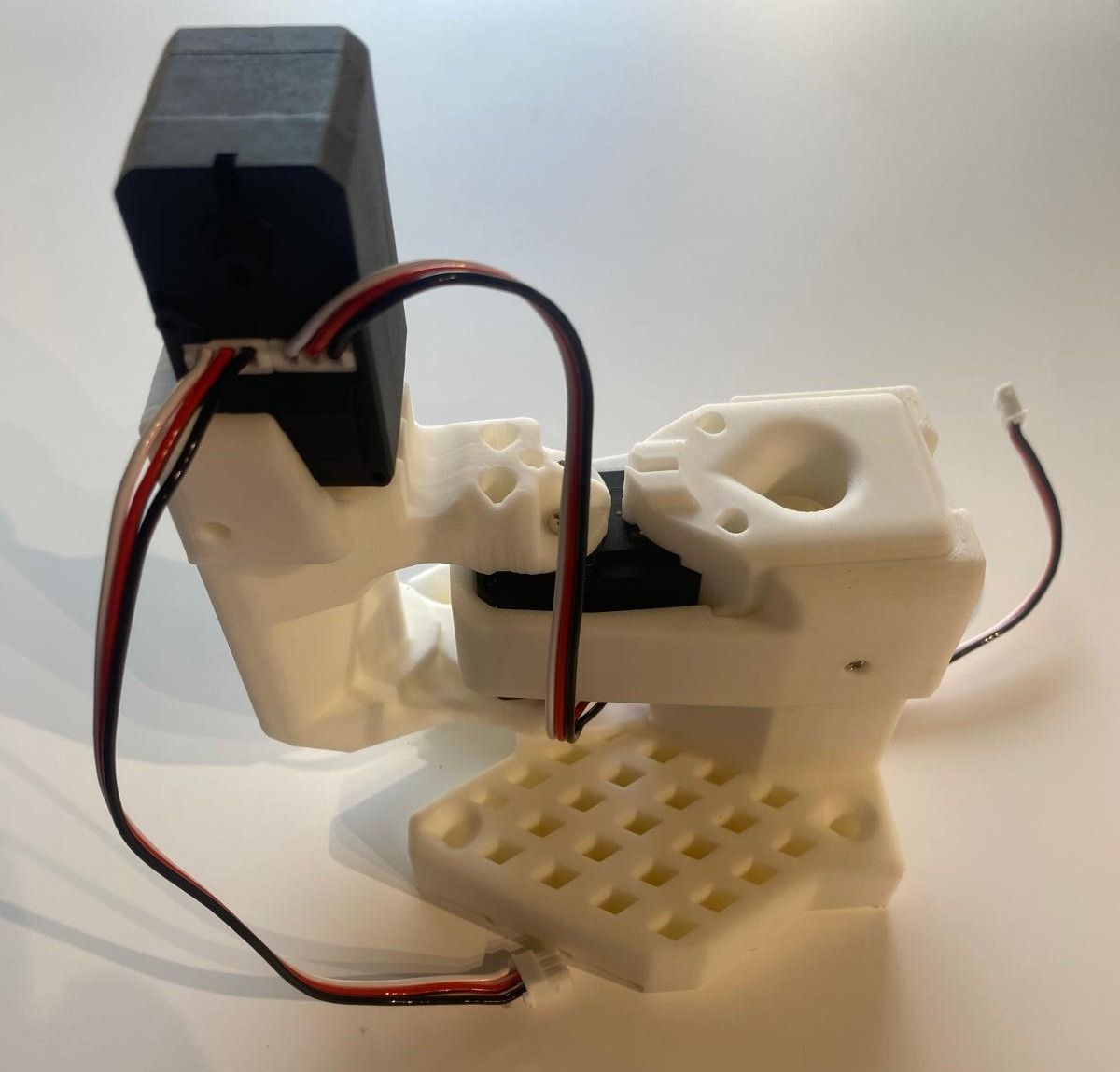

Step 9: Install Motor 2
  • Slide the second motor in from the top and link the wire from motor 1 to motor 2.
Step 10: Attach Shoulder Holder
  • Ensure the wire from motor 1 to motor 2 goes behind the holder while the other wire is routed upward (see photo).
  • This part can be tight to assemble, you can use a workbench like the image or a similar setup to push the part around the motor.

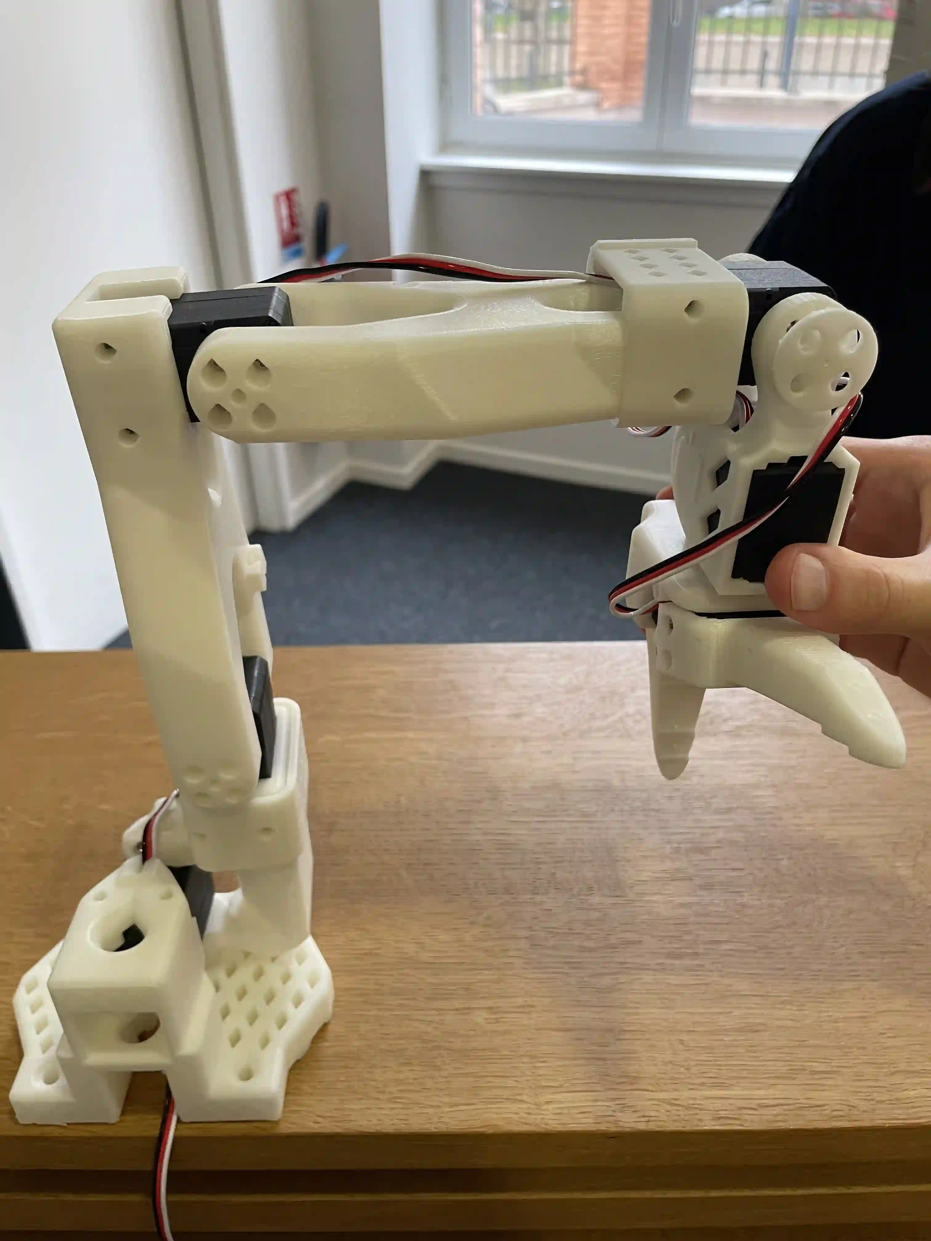

Step 27: Mount Controller
Assembly complete proceed to Leader arm assembly.
