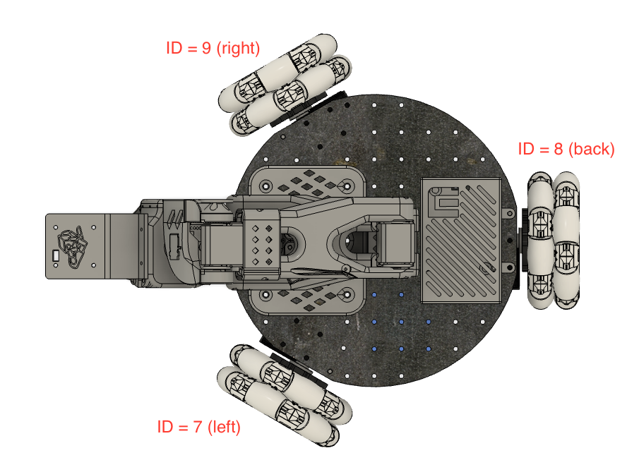

Mobile base (LeKiwi)
Update config

"left_wheel": (7, "sts3215"),
"back_wheel": (8, "sts3215"),
