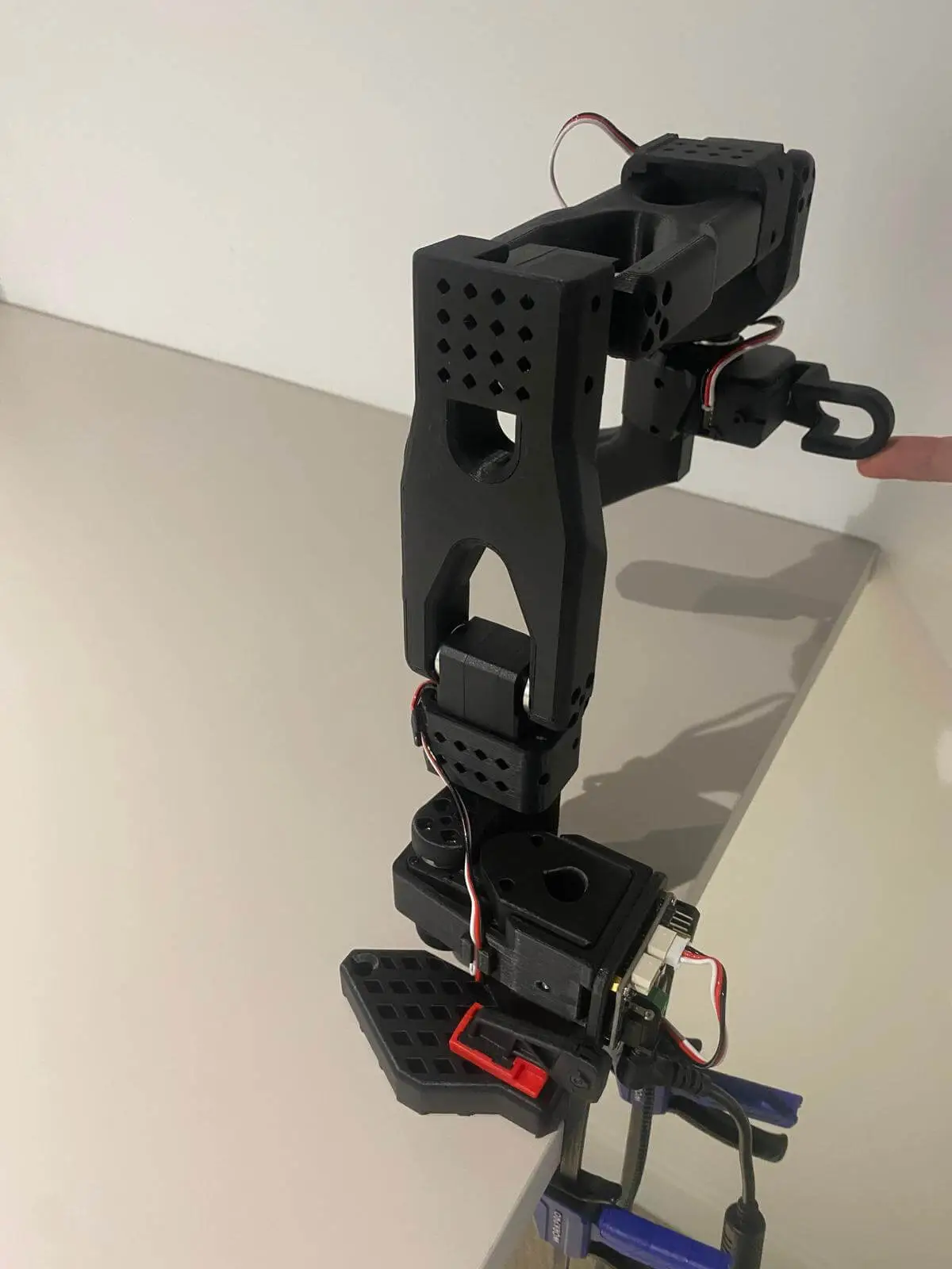

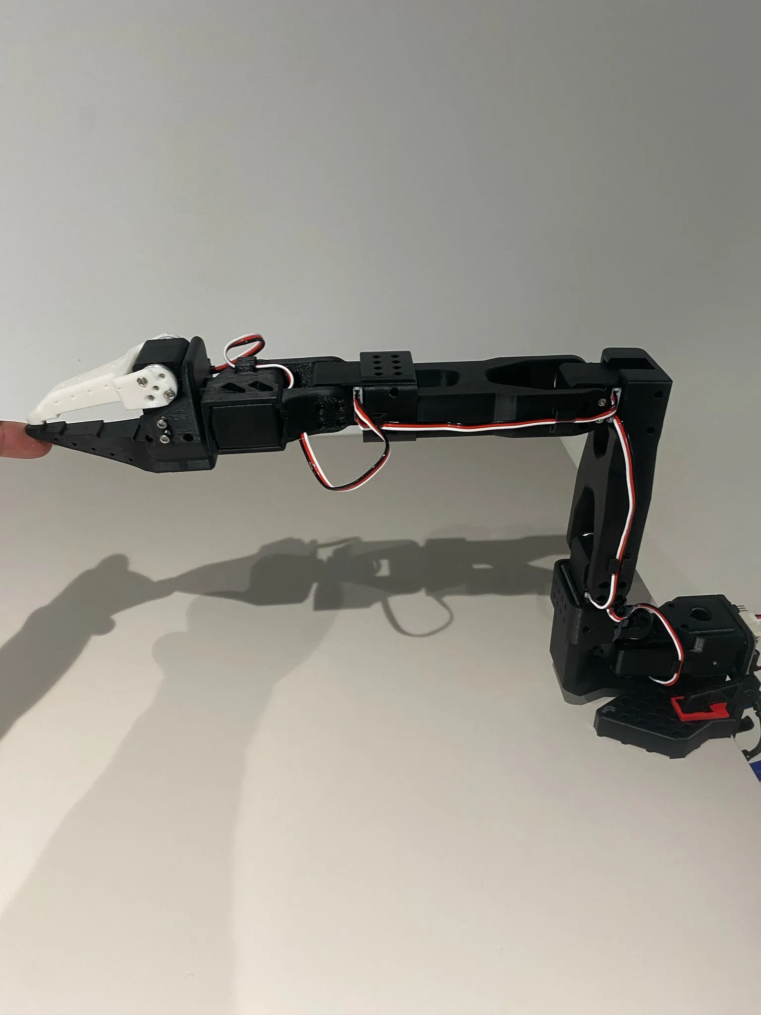

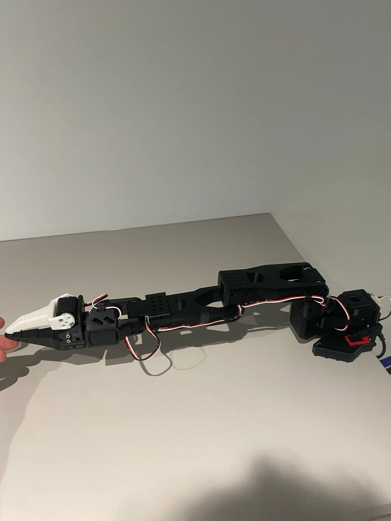

Next, you'll need to calibrate your SO-101 robot to ensure that the leader and follower arms have the same position values when they are in the same physical position. The calibration process is very important because it allows a neural network trained on one SO-101 robot to work on another.
Manual calibration of follower arm
You will need to move the follower arm to these positions sequentially, note that the rotated position is on the right side of the robot and you have to open the gripper fully.
1. Middle position 2. Zero position 3. Rotated position 4. Rest position
SO-101 leader arm middle position SO-101 leader arm zero position SO-101 leader arm rotated position SO-101 leader arm rest position
  --robot.type=so101 \
  --robot.cameras='{}' \
  --control.type=calibrate \
Manual calibration of leader arm
You will also need to move the leader arm to these positions sequentially:
