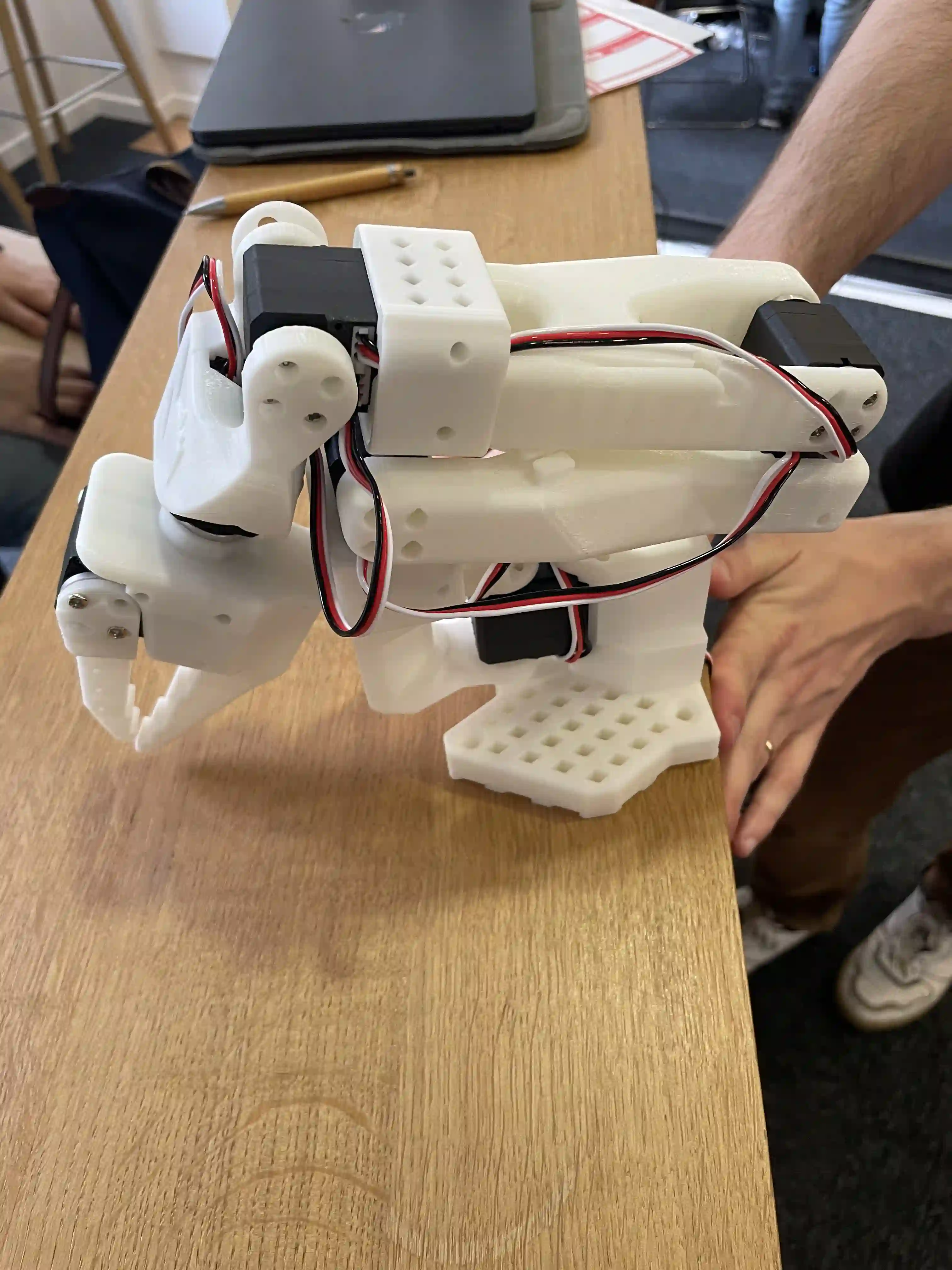

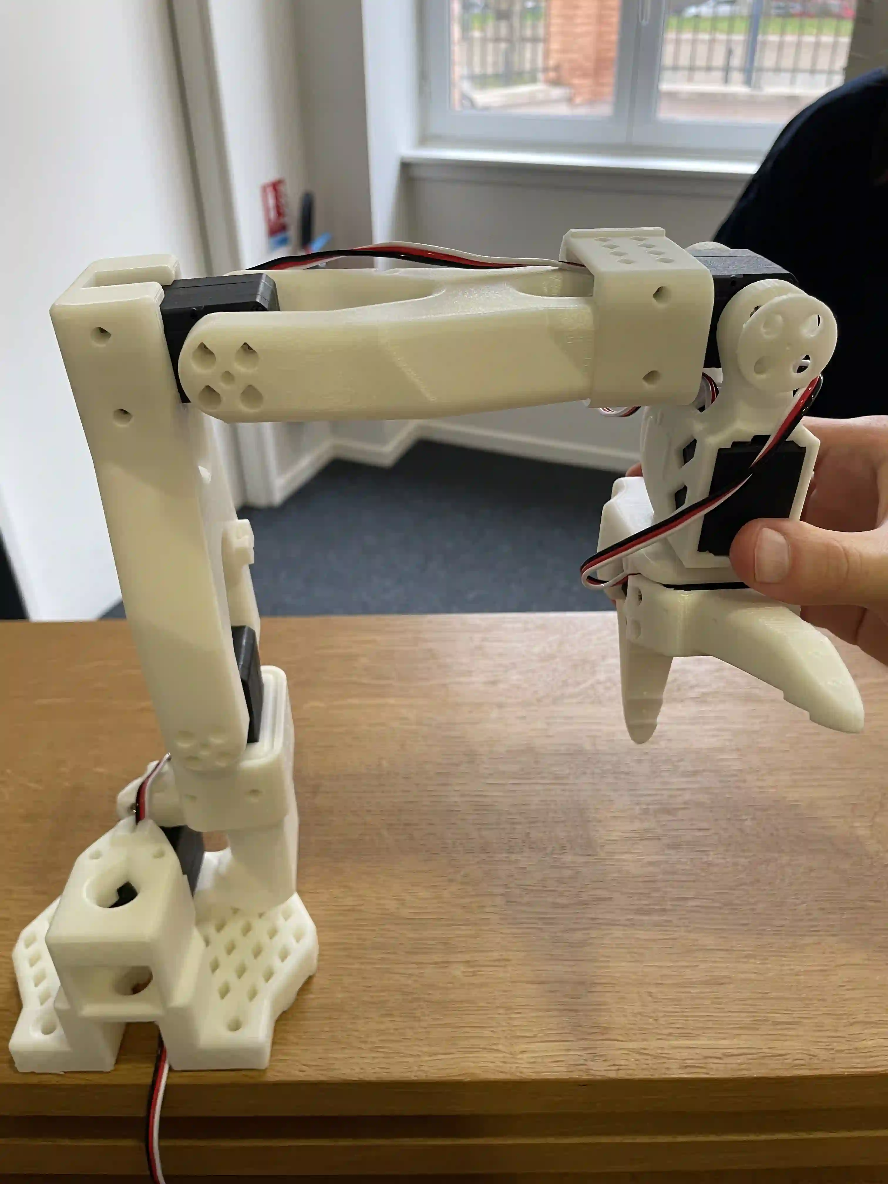

Follow the video for assembling the arms. It is important to insert the cables into the motor that is being assembled before you assemble the motor into the arm! Inserting the cables beforehand is much easier than doing this afterward. The first arm should take a bit more than 1 hour to assemble, but once you get used to it, you can do it under 1 hour for the second arm.

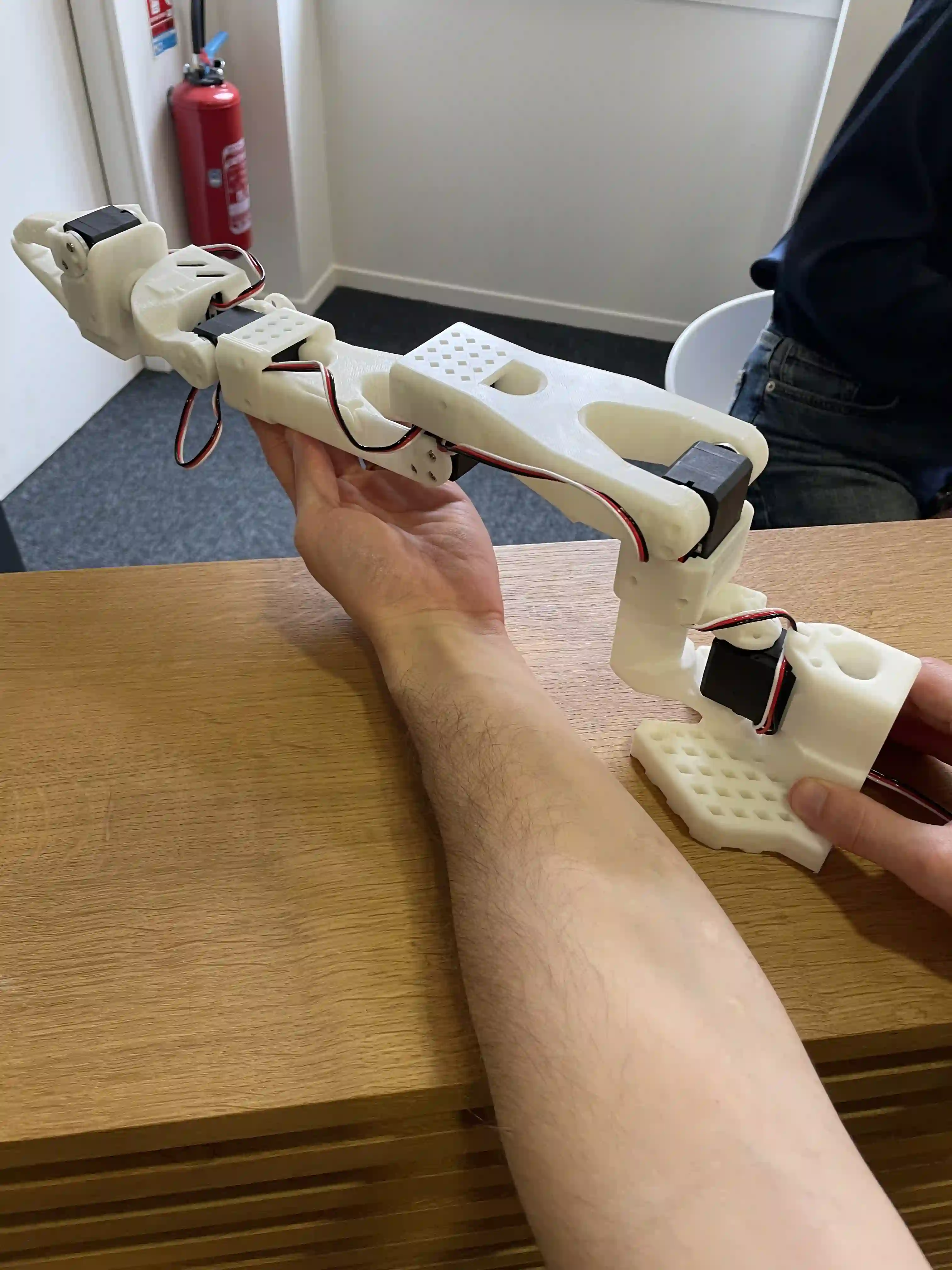

Follow step 6 of the assembly video which illustrates the manual calibration. You will need to move the leader arm to these positions sequentially:
